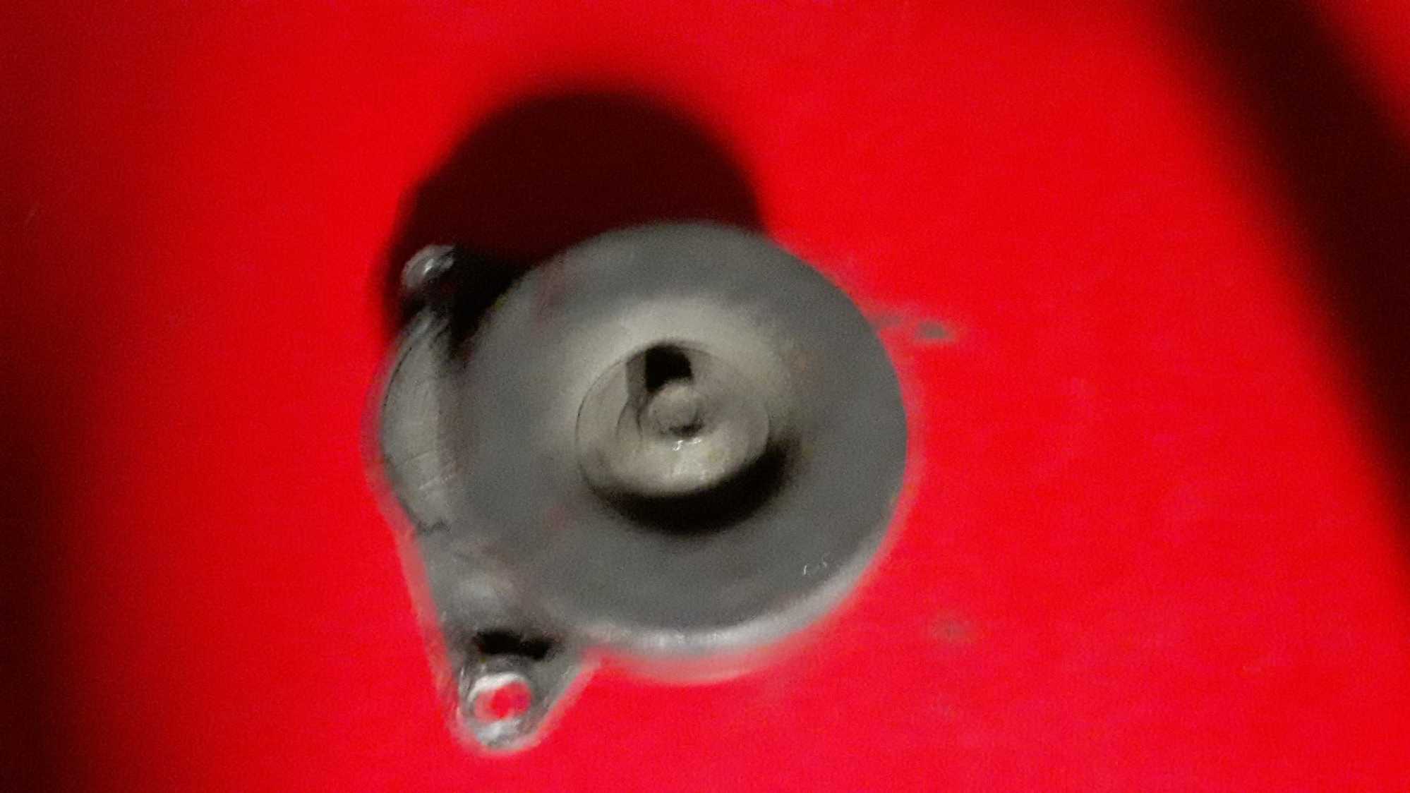

If the belt came off and your are trying to put it back together then with the same alternator and it will not go something is together wrong. The only other explanation I know of is the belt tension broke inside when it was released and will not return to its original position.
So would getting a new belt tensioner solve the problem?
Or is it the fixture in the engine bay, under the hood, to which the belt tensioner is attached, that would be the problem?

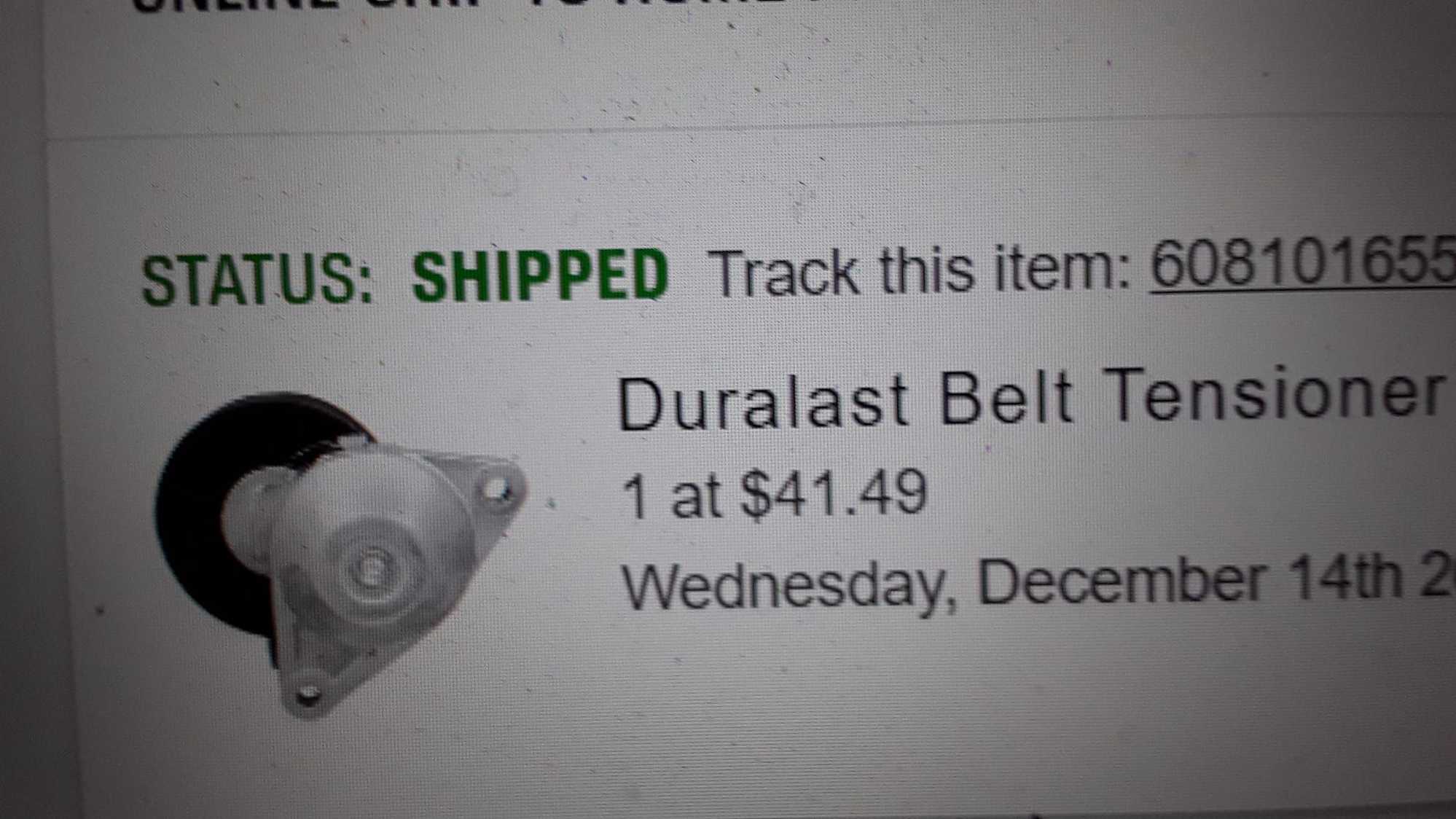

Here's what I ordered and what the existing belt tensioner looks like....
