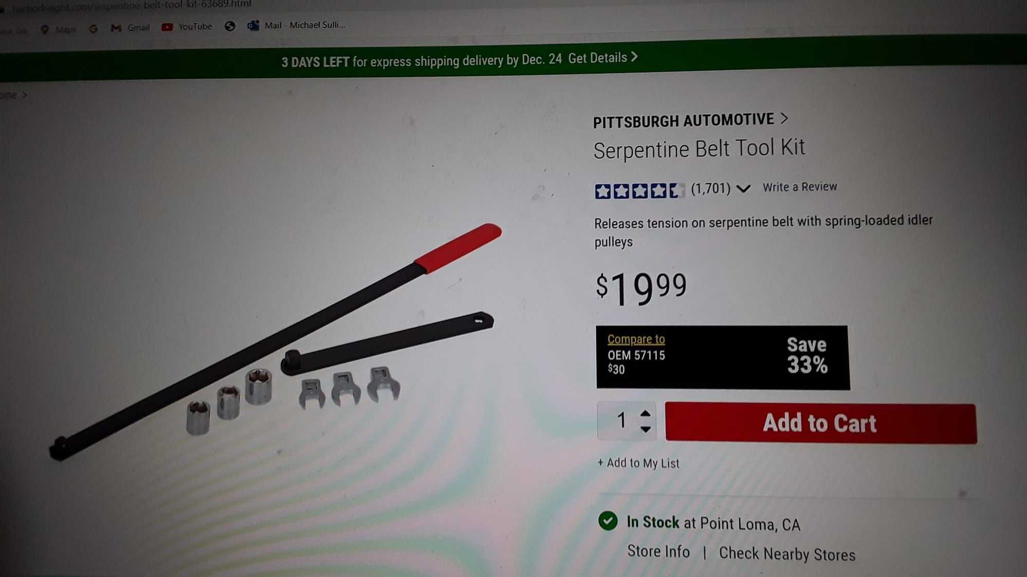

Someone said that a "serpentine belt tool kit" is helpful
