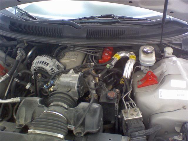

Okie dokie the first one is the engine bay overview. My coils are red so they are a little more visible. Yours will probably be black, drivers side of the engine just under the cowl.

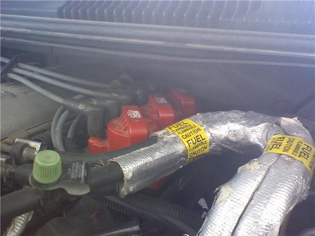

This is just a close up. I wrote on my coils when I was putting some stuff on that required theyr removal so thats what the numbers are. The coil for 1 and 4 is the very back coil.
