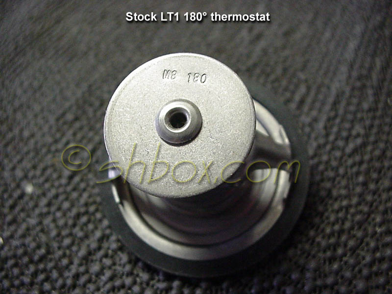

you could look it up at rockauto site and see what they show. rock will show different brands and prices for the correct part.

Yeah that's the pics I was looking at. The t stat that I took out had bends in the bottom ring of the stat. I didn't really pay attention to the one I put it. I'm gonna take it back out when I get home to look at it.

easy to get em in upside down but that make it run hot.

Yeah. Its in with the spring facing down toward the w pump.
