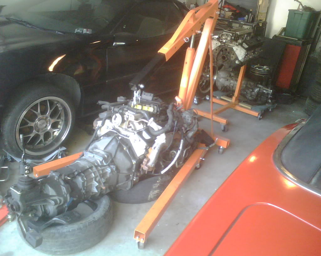

The biggest differents between the stock and after market, beside the throw distance, is the stops. The afteramarket shifters have adjustbale set screws the stop the shifter from putting a bunch of stress in to your shift rods and forks. You fogot to mention what tranny you have. This is a stock T56 with a Hurst handle on it like the SS had.

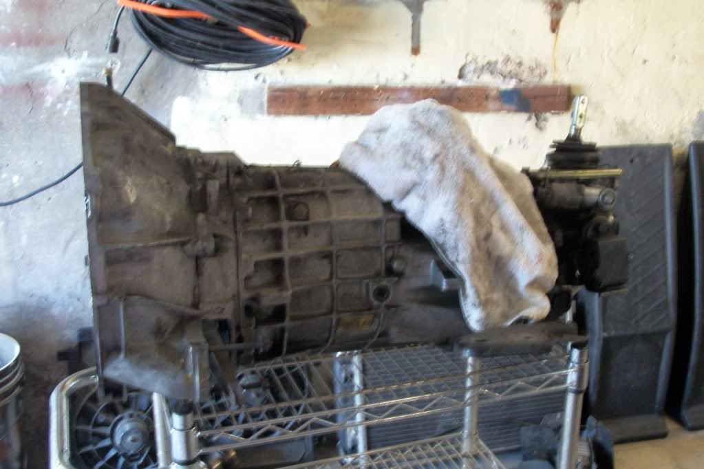

Close up of the shifter

Haha oops!! Yes mine is the T56 manual.. Thanks for the pic's. I will look at them when I get home so I can blow them up... I can't really tell on my phone.

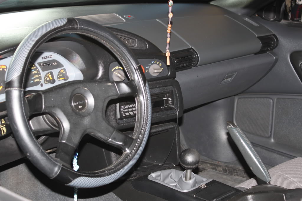

Here is a pic of my interior. I know you cant see the base. but see the shifter shaft. it is quite different then the one in your picName:  IMG_9053.jpg
