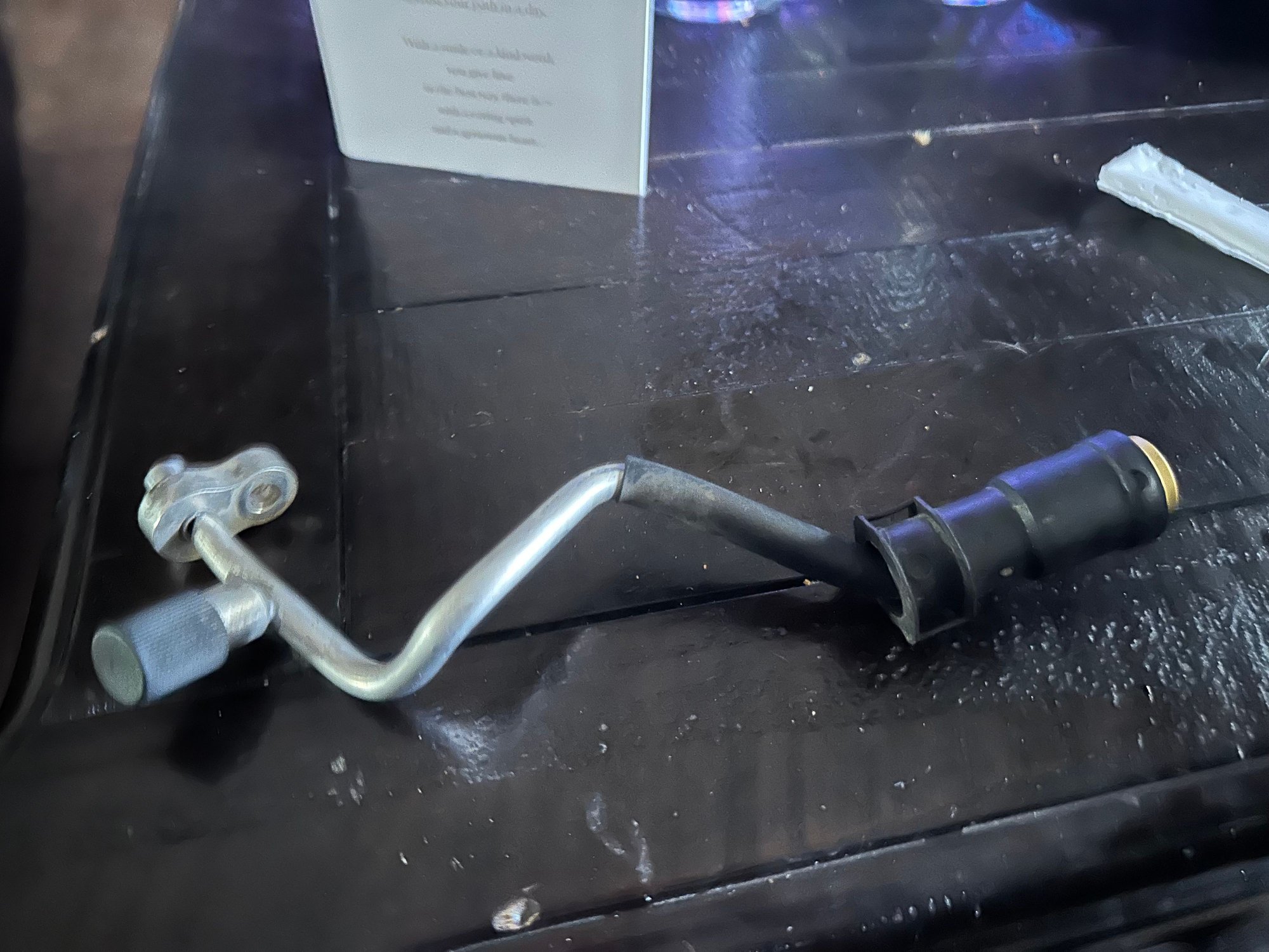

pipe looks to have a pretty good split in it right by the fitting. not sure a guy can weld it back together without effecting the fittings ability to seal. first thought is to call around the local wrecking yards and see if any are available that are any good.
You sir are correct!! Cannot be repaired due to position of tear. I’ve been down all avenues & nothing.
