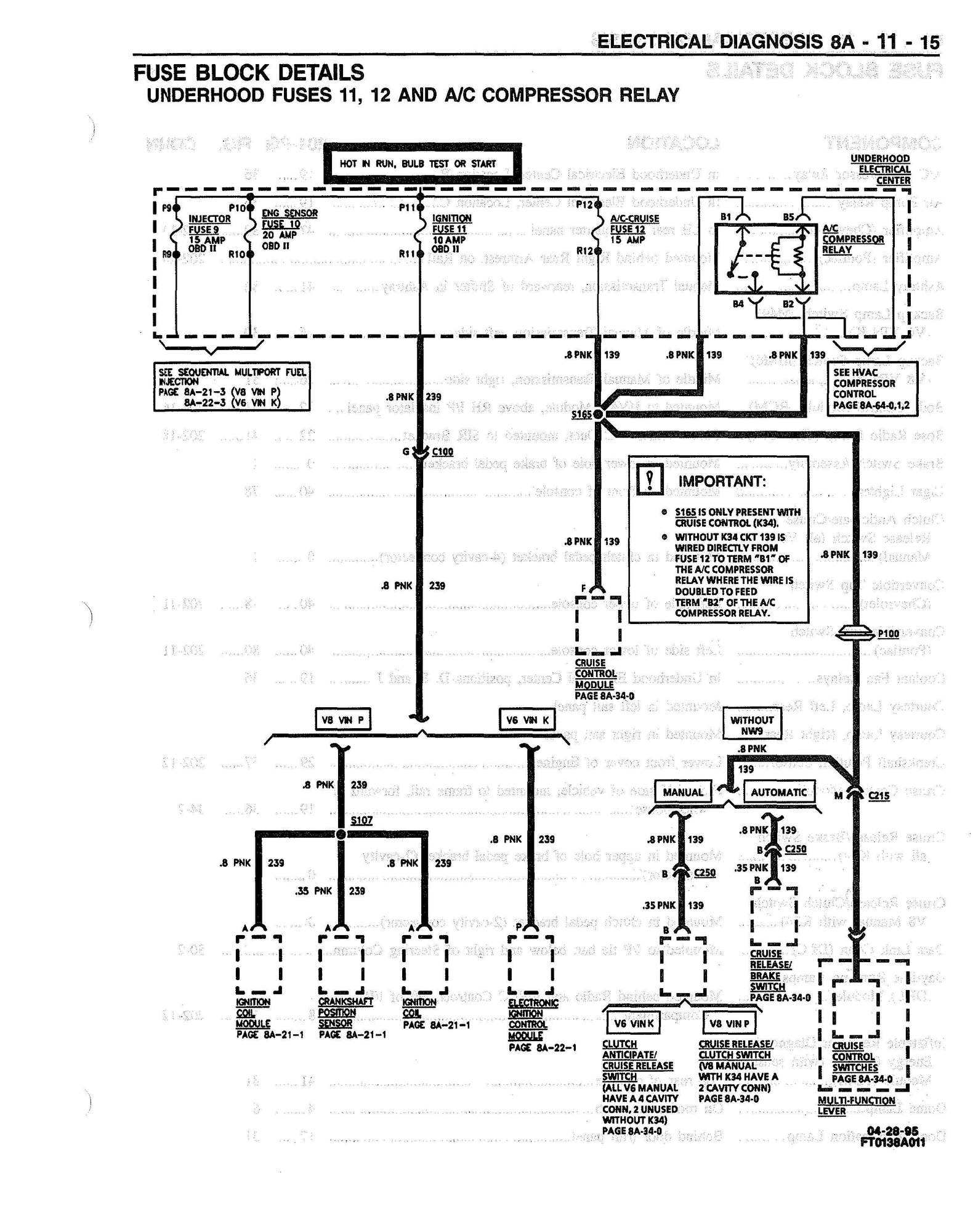

You should be to pull fuse #12 in the underhood fuse panel to disable the system. Be aware though that doing this will also disable the A/C compressor which supplies cold air for the windshield defroster.

Its been a while but I think the LT1 had a separate throttle body cable. You could just unclip that.
