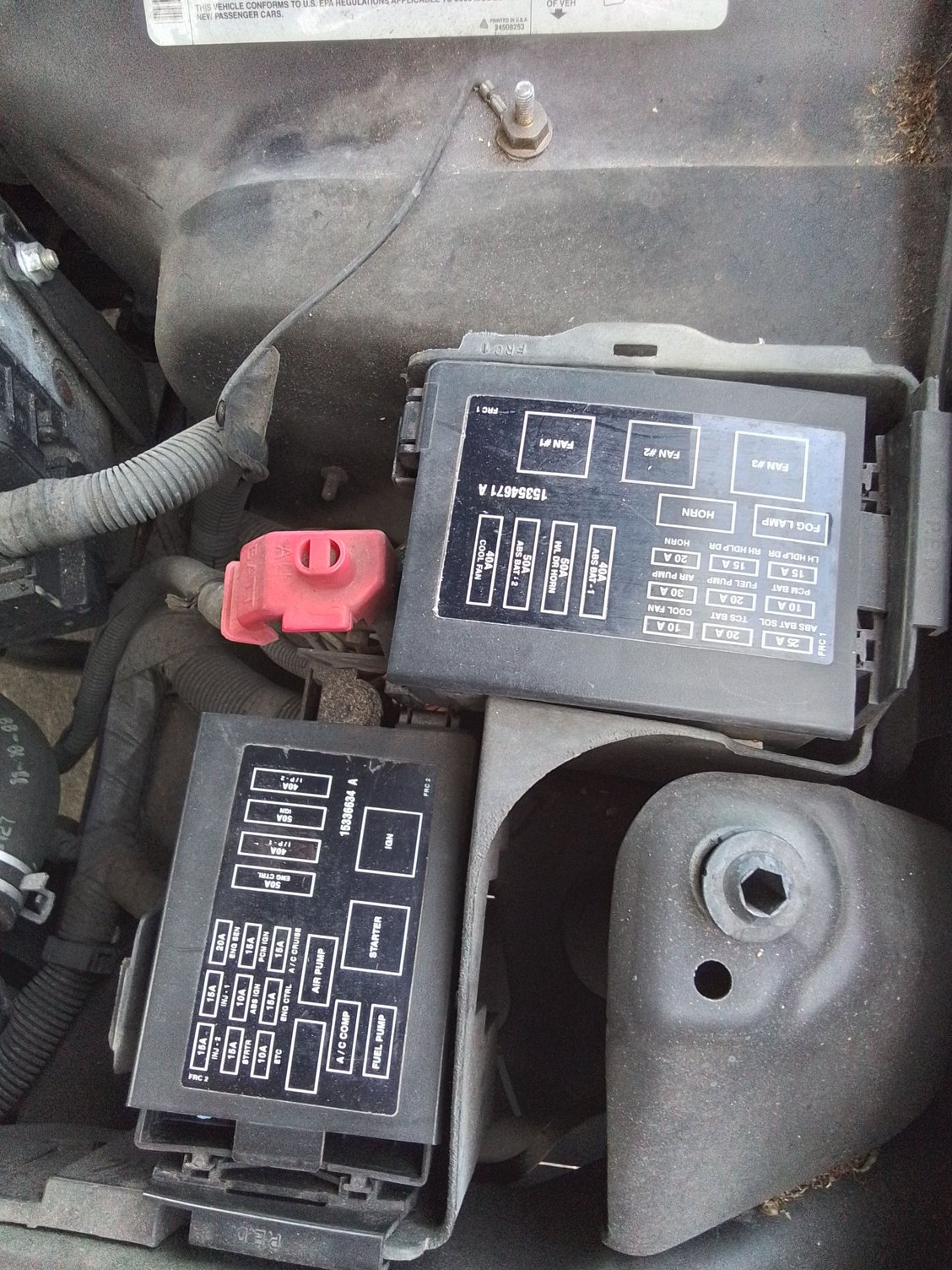

I'm youtubing to see if I can use a clamp meter for volt drop test, since my DMM leads aren't long enough
From battery (+) to this IPFUSE box to starter
I can't figure out how to remove the red cap to check voltage drop to ip fuse box, but has ground continuity to driver's shock mount ground wire. F! Is always my word-of-the-day, moreso lately. Thanx all for tips and advice. My "ugh" comment from before was because my hands go numb everytime I have to work on starter , I even upgraded my creeper with an adjustable head rest to take pressure off pinched nerves in neck, oh well. That's why I don't want to have to go under the dash to back probe the ignition switch
