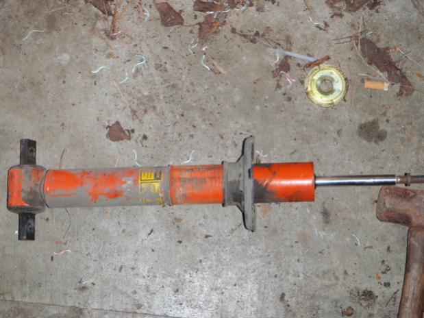

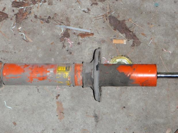

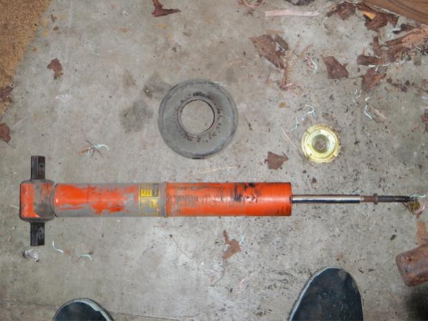

Posts: 22,027
yes the old spring shelf comes off with a little help of a hammer. dont beat the crap out of it. should come off fairly easy. lube up the upper shaft threads of the new front ones with anti seize really good. check tie rod ends while u are at it. good time to change sense u have to have front alined anyways.
i dont think they come off, i beat the **** out of mine and it still didnt budge, im pretty sure it was heat pressed on
Old Jun 3, 2009 | 02:59 PM
Posts: 22,027
i just went out and took one off my old shock. u want to buy it? lol
