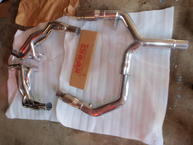

catted y and headers

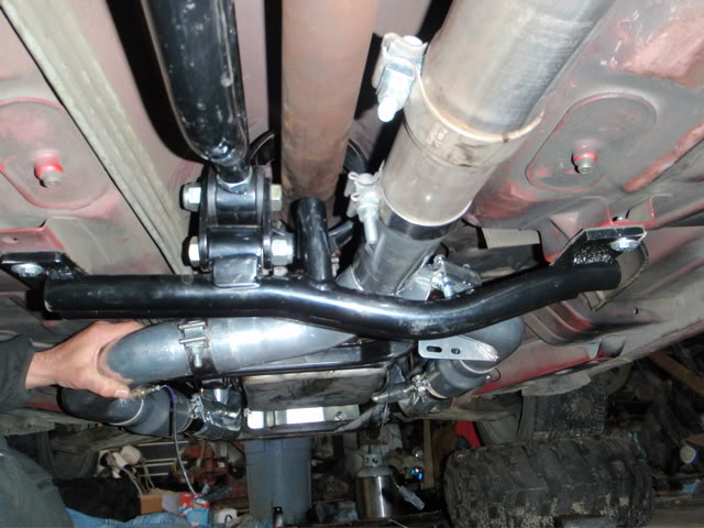

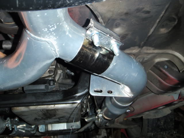

installed

craby what size are the headers on your system? has anybody had any clearance issues with long pipes?
Old Oct 1, 2011 | 08:44 PM
  #17
Posts: 22,040
1 3/4 in to a 3 in kooks. fit fine. had to do a little work to get the y pipe to fit. i also switched to a straight cross bar, that dip kept hitting everything. kooks alow for the straight one but the salesmen wasnt sure so i got the header one first.
