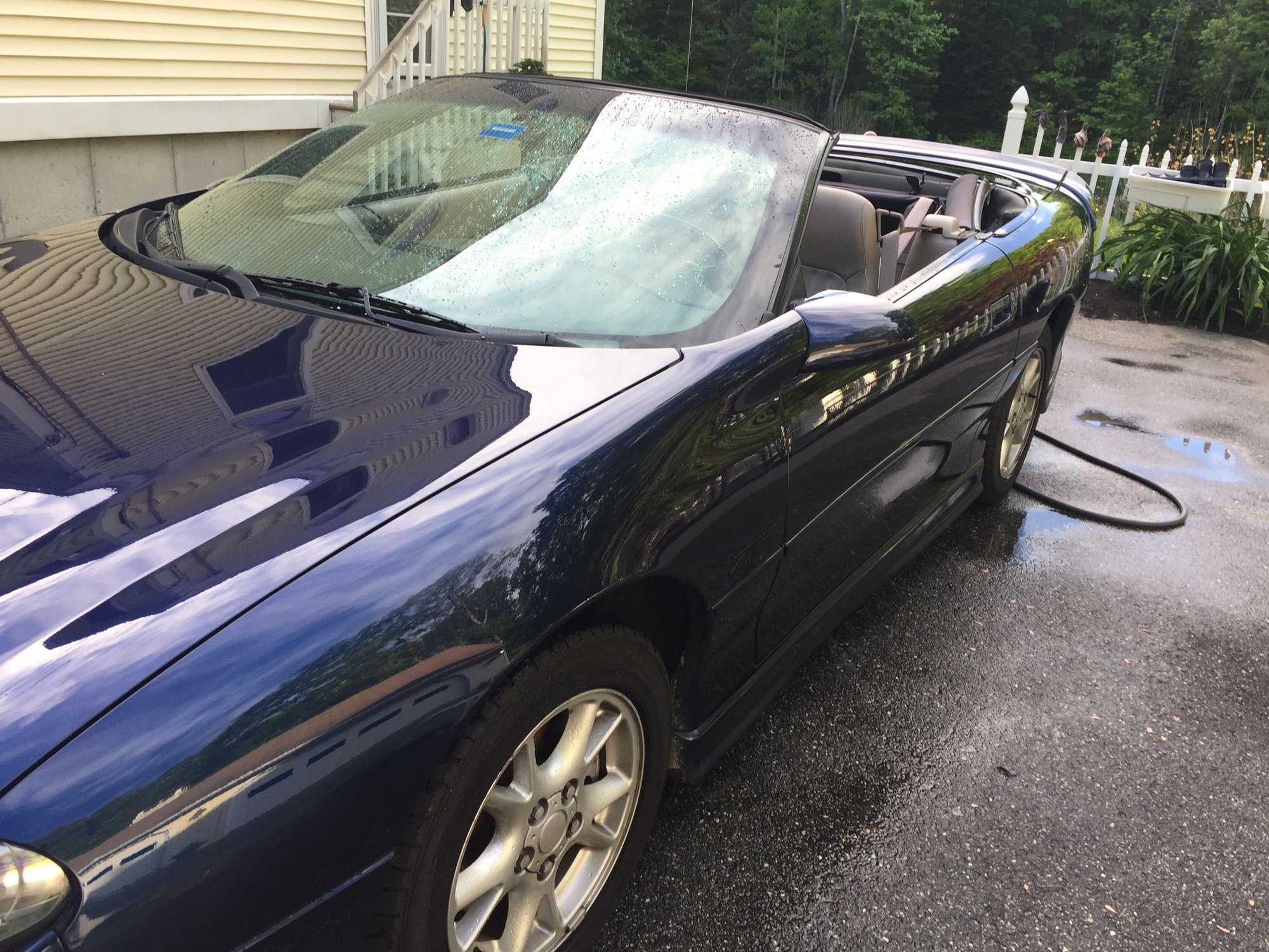

Hi does anyone here have a convertible boot? Ive got a 2002 z28 convertible and i want to get a boot for the open convertible. I see an oem one on ebay but have no idea if there is any added hardware needed to secure it or if it will clip onto my existing setup? The seller indicated there was none needed but id like to verify. Thanks
