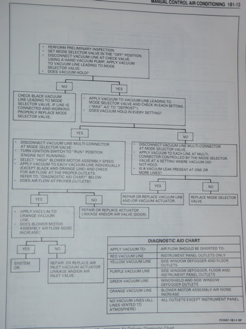

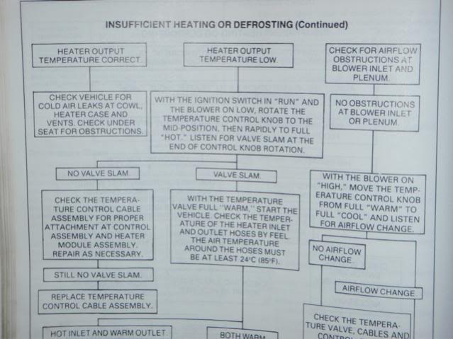

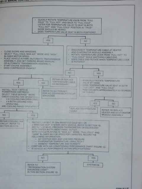

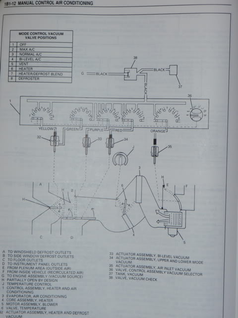

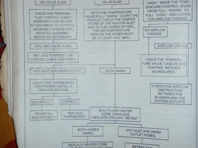

Default heater and ac tests
ok guys here u go. hope it helps.

Where does the vacuum for the vent **** come from?
mine quit working..........no more pssssssssssssssssss when i turn it off..
i think i have a vacuum leak
somewhere
Old May 12, 2010 | 05:56 PM
Posts: 22,027
under the hood there should be a hose coming from the wiring harness on the passenger side. it hooks into the intake manifold on the passenger side next to the vacuum line for the fuel pressure regulator.

Do you have any pics, I've searched on here and came up with nothing........

on the 3.4 the vacuum is at the rear of the intake manifold, center and top. hooks into a vacuum fitting that has a larger hose and smaller hose on it. the one u want is the smaller vacuum goes into a wiring harness and should be the only one that does.
