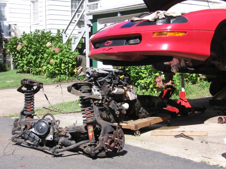

You can do it either way. From what I've seen and read, it's a lot easier to go out the bottom. Either Massey or Gorn had a picture of how they lifted the body with a cherry picker.
Old Apr 9, 2011 | 08:11 AM
Posts: 22,039
agree with mikey, it can be done either way but out the bottom is easier.

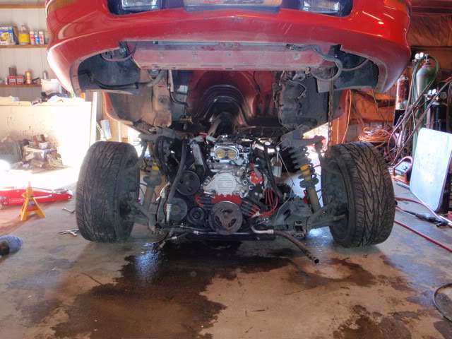

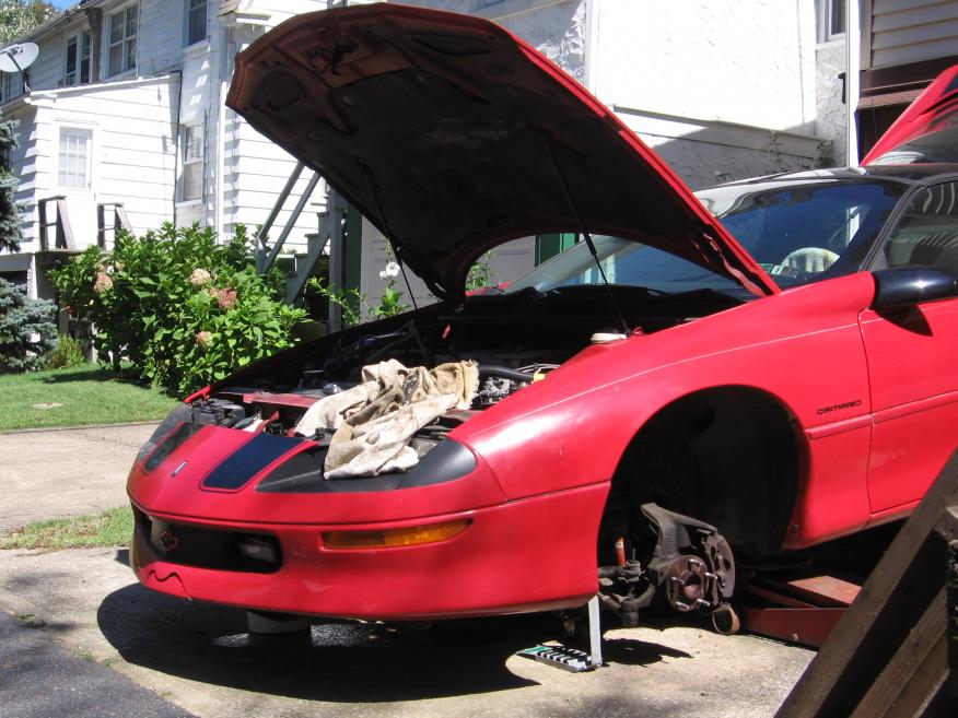

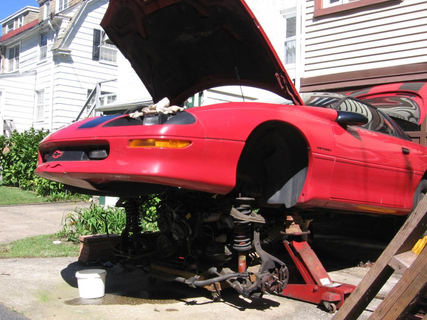

I've done a lot of engine swaps. I looked at what was going to be required to pull it from the top. But how? Only the front two cylinder stick ahead of the cowl and the upper intake it jammed up against that cowl. You have to do a lot of disassembly to get that motor out the top.
I dropped it out the bottom. It wasn't fun but I think it was easier that the top route.
More accurately, I lowered the front of the car way down while the back wheels were on ramps. The subframe was resting on a dolly. Then I lifted the body up and away from the subframe/engein/trans.
Attached Thumbnails 93 Camaro. v6 3.4L Need Help!!-img_0427.jpg   93 Camaro. v6 3.4L Need Help!!-img_0430.jpg   93 Camaro. v6 3.4L Need Help!!-img_0431.jpg
