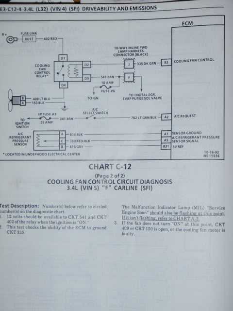

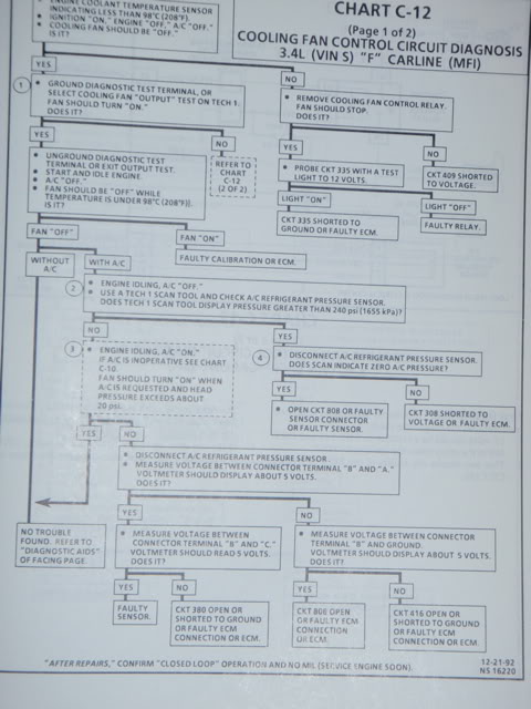

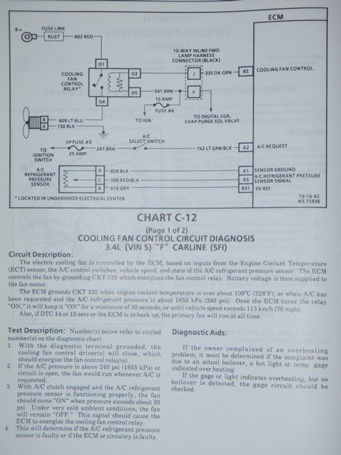

Old Oct 4, 2010 | 02:17 AM
Posts: 22,001
Size:  65.0 KBName:  PA030002.jpg
Size:  50.8 KBName:  PA030005.jpg
