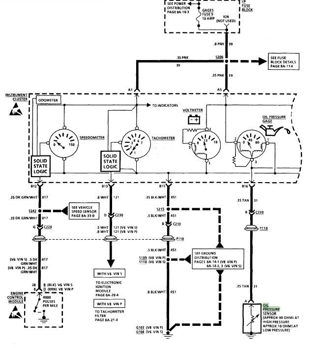

You said that your oil pressure switch was a one pin. You might want to verify that is the correct part installed. My 94 camaro 3.4L has a two pin oil pressure switch. I just purchased one last month. I don't know if or how the oil switch relates to powering the ECM. Just a suggestion to look at.

correct. I pulled plug off, removed rubber boot looking thing and pulled wire from the loom. From plug to main harness only one wire. Kinda bumfuzzled me honestly as I expected 2-3. Idk. Early engineering marvels I suppose 🤣

So, about the oil pressure sensor, the manual is a little weird.
The schematic only shows a single wire, but the connector is shown as a three-wire.
If I remember right, the single-wire thing with one metal contact is a warning light switch and the one with the three-way connector is a gauge sender. The schematic shows gauges, but if you don't have an oil pressure gauge maybe you have the switch.
On the other hand, there is no mention of oil pressure being tied in to the PCM, so either way it shouldn't matter.
