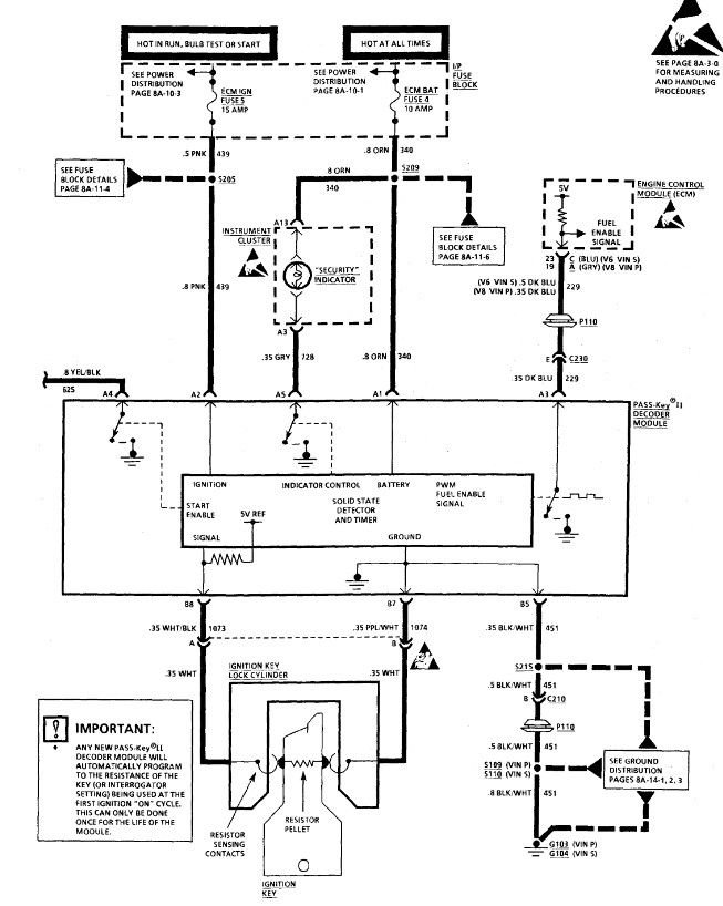

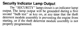

Manual says this
So, the fuel enable signal is modulated, not a straight up voltage.
It also says you need to have a 5 second ground at key on for the bulb test.
That's the gray wire out the TDM.

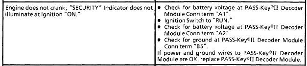

Also, the diag chart says this:
That isn't your exact case, as it seems you can crank, but never get fuel. However, since you have no Security light, it would seem module is the problem.
I would test that A5 gray wire for the 5 second ground at key on just as a sanity check. If you don't get that, I might try popping the module open and look for circuit board damage, loose solder, corrosion, etc. It looks like it's relatively easy to open.
