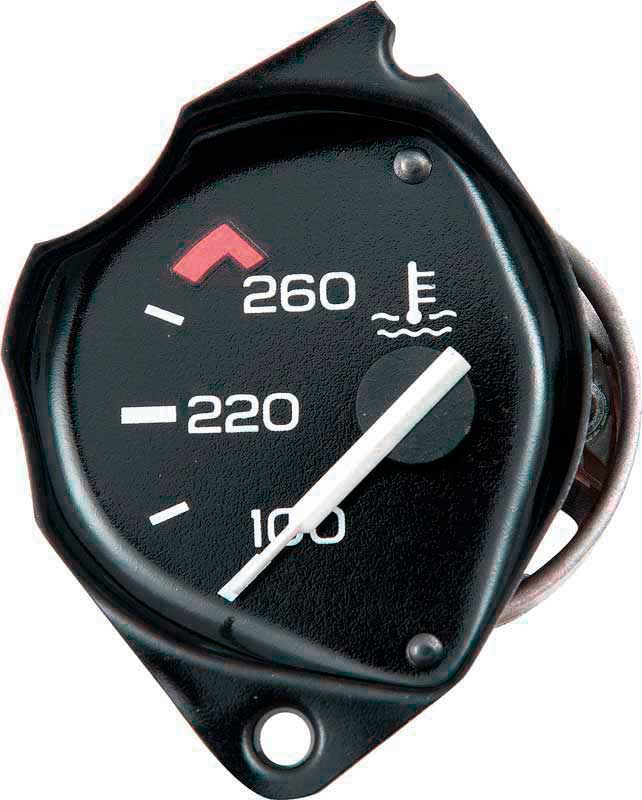

It gets for me close to last white range which could be 230; the white stick below all the orange ones. i don't know what number is that since i had a tbi tramatic brain injury....260 is the top and i am at the last white part in the attached pic probably 230 after driving 10 miles in 70 degree Southern California weather. It fluctuates, it just stays at like 230 on the temp guage 2-4 times in 10 miles of day driving in aforesaid climate.
Is this normal temperature I mean up in the 230 zone is kind of scary rright?

here is the attachment, notice the last White Line, that's where I am assuming is at the 230 mark just before the red or orange zones, too close for comfort in my opinion
But, it may be freakin natural for a 1993 a 23 year old some odd car to be getting those high temp's so it's normal? to be at 230 after 45 minutes or 1 hour (10- 15 miles) of daytime driving during the hot So. Cal sun for like 3 to 5 x (times) then lower to the middle point on the temp guage. Note all my driving and the consequent temp gauge readings are read while i am surface street driving, meaning on the streets with stop lights traffic lights stop signs bumper to bumper rush hour traffic, etc., the motor and accompanying temp readings would be much cooler on the hghwy, but legally i cannot drive on highways right now

Default here it is again: temp gauge photo on a 93 camaro
notice what i am referring in the above 2 posts at a 230 reading is the little less than a full line below the last numbered line of 260
appearing at that spot 6-9 times in 1 hour of surface street (no highway driving) driving may be cause for concern *but when it is less like: 3-5 x and then it goes back to the middle point on the temp gauge for 1 hour of surface street 70 deg. Fahr. daytime driving may be normal for a 23 yr old car like my 1993 Camaro.
