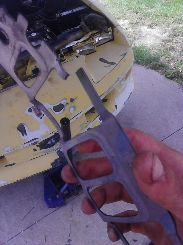

Bad gasket on the lower intake manifold was the culprit. I will invest in bearing very soon, is there a sticky I can go to for advice?
