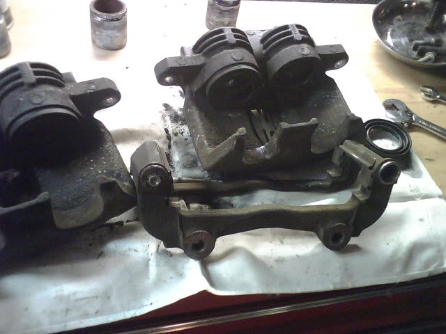

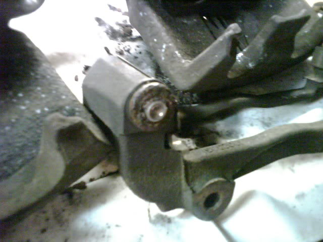

I am doing a front brake upgrade on my 96. I got the parts off a 2000. When I started to tear apart the Calipers to powder coat and rebuild them I found that two of the four sliders in the caliper brackets where frozen. Both where rusted bad and they broke. Of course one in each bracket. Does anyone know where I can find these brakets? I can find the ones for the rear online. Tomorrow I will try to machine out the sliders but I am not to hopful. Machinig fused steel out of aluminimum does not always go real well.

This is what I am up against. The shinny round thing in the middle of all that rust is the broken off slider.

Old Aug 23, 2009 | 10:19 PM
Posts: 22,027
heat it up and spray it good with penitration oil. the bracket is aluminum? can u get a punch at it from the backside?
Old Aug 24, 2009 | 03:19 AM
Its not a thru hole.
Old Aug 25, 2009 | 08:21 AM
Posts: 22,027
i think u are going in the only direction u can. drill it out, very carefully. could spray it down and try a ez out.
Old Aug 25, 2009 | 08:47 AM
I am thinking I need to find other ones. Look how nice and shine the outside rim of the hole is on the other side of the brakets. There is a dust seal that goes around that. I have been soaking the bracket for 2 days and it still looks like a pitted mess on the outside. Hopfully I can find a good one at the local U-pull it yard. I have had no luck finding them new.
