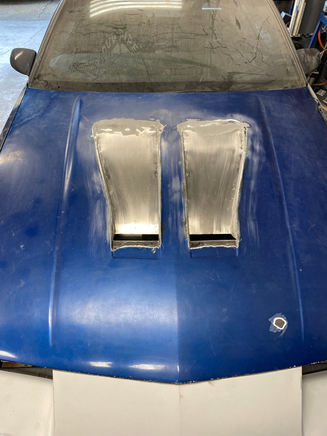

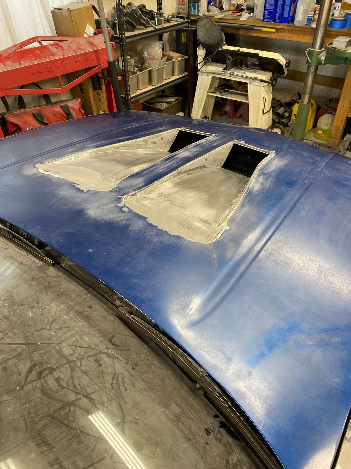

I wanted something extraordinary and unique for my build and this is what I came up with.
Bead rolled and shrank the pans
Added some side extensions
Fitted to the hood
After about 12 hours of tig welding
The fabrication is complete and ready for primer and finishing. The entire car will be blocked and painted in the future.

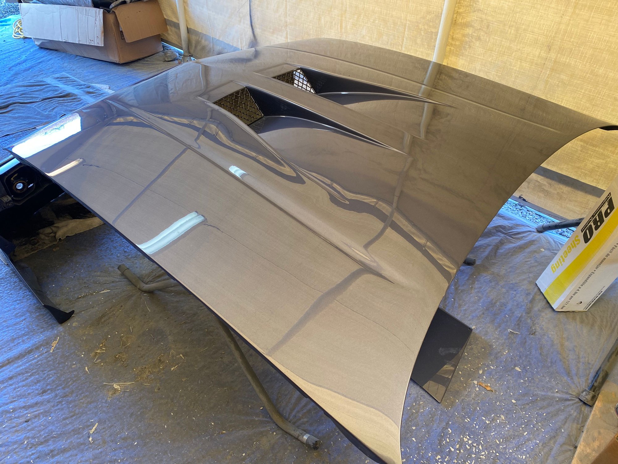

Successful test fit, like it was made for it.

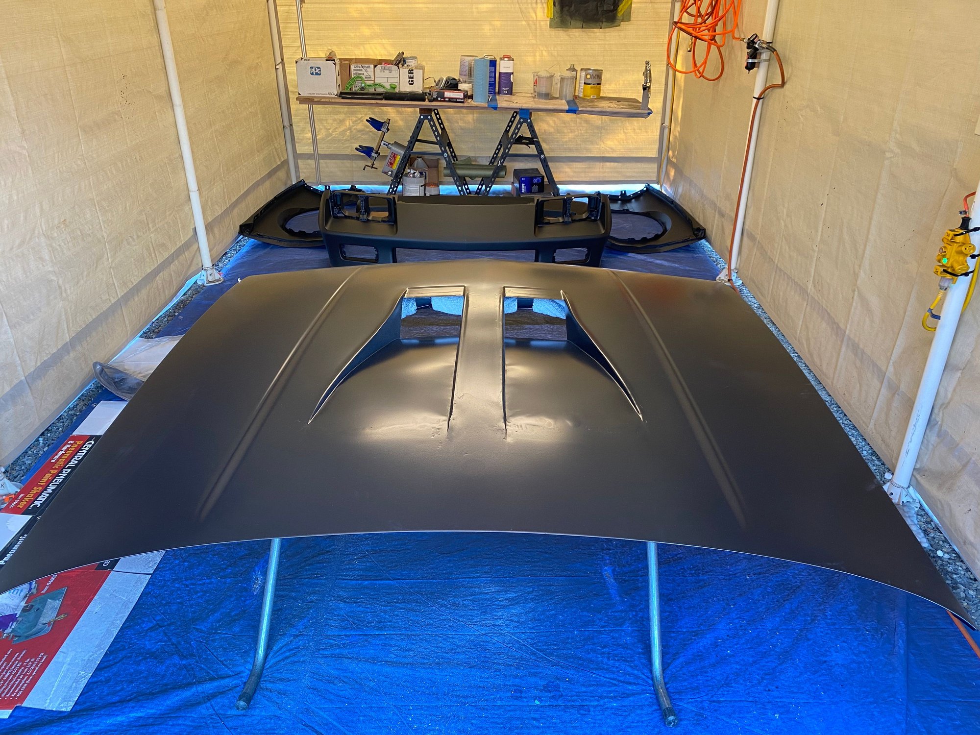

Starting to get things in epoxy primer

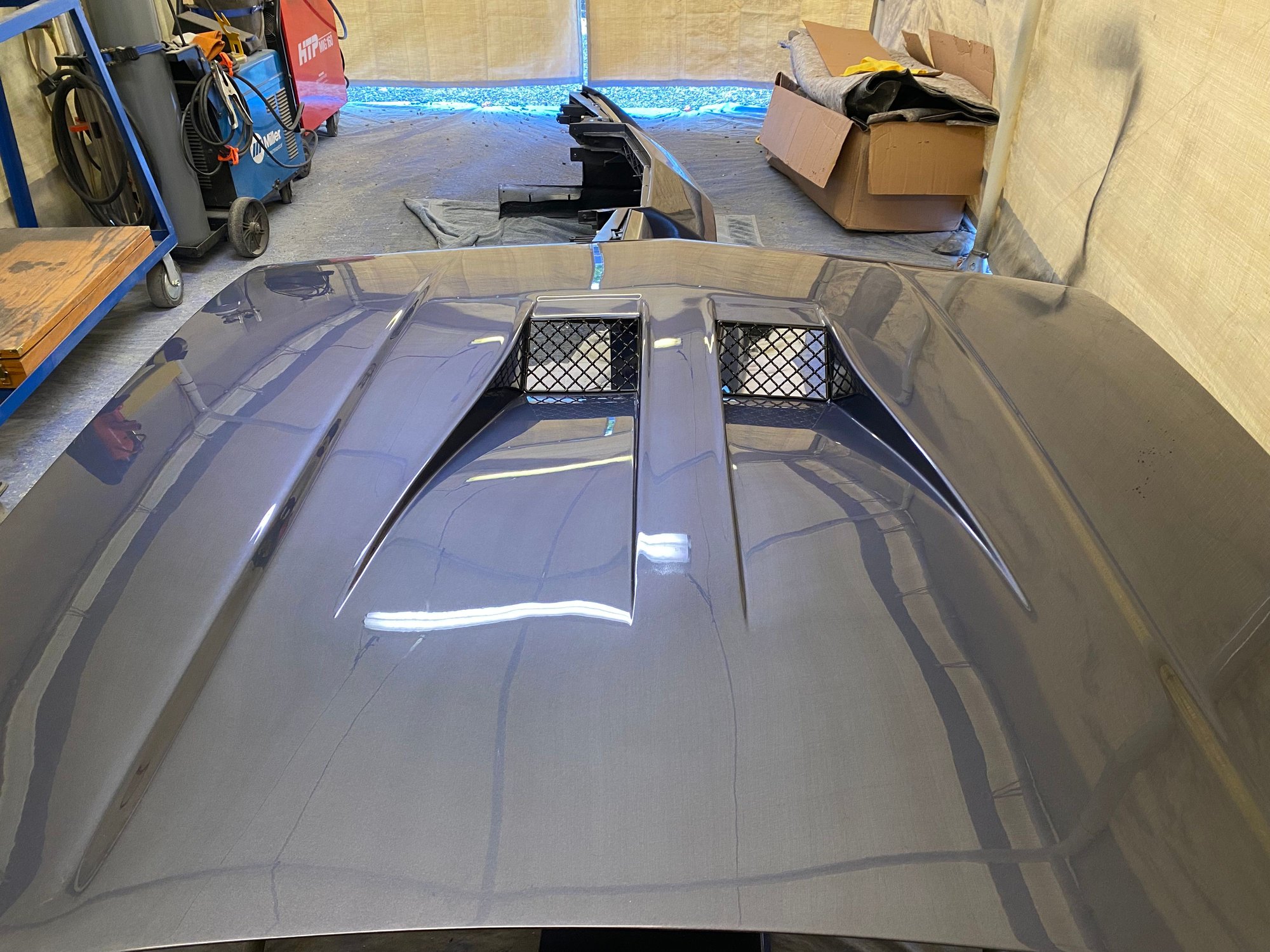

Final update to this thread. The grills have been installed and the hood is ready to be installed on the car. Images of the completed car will be posted in the “Projects” thread.
