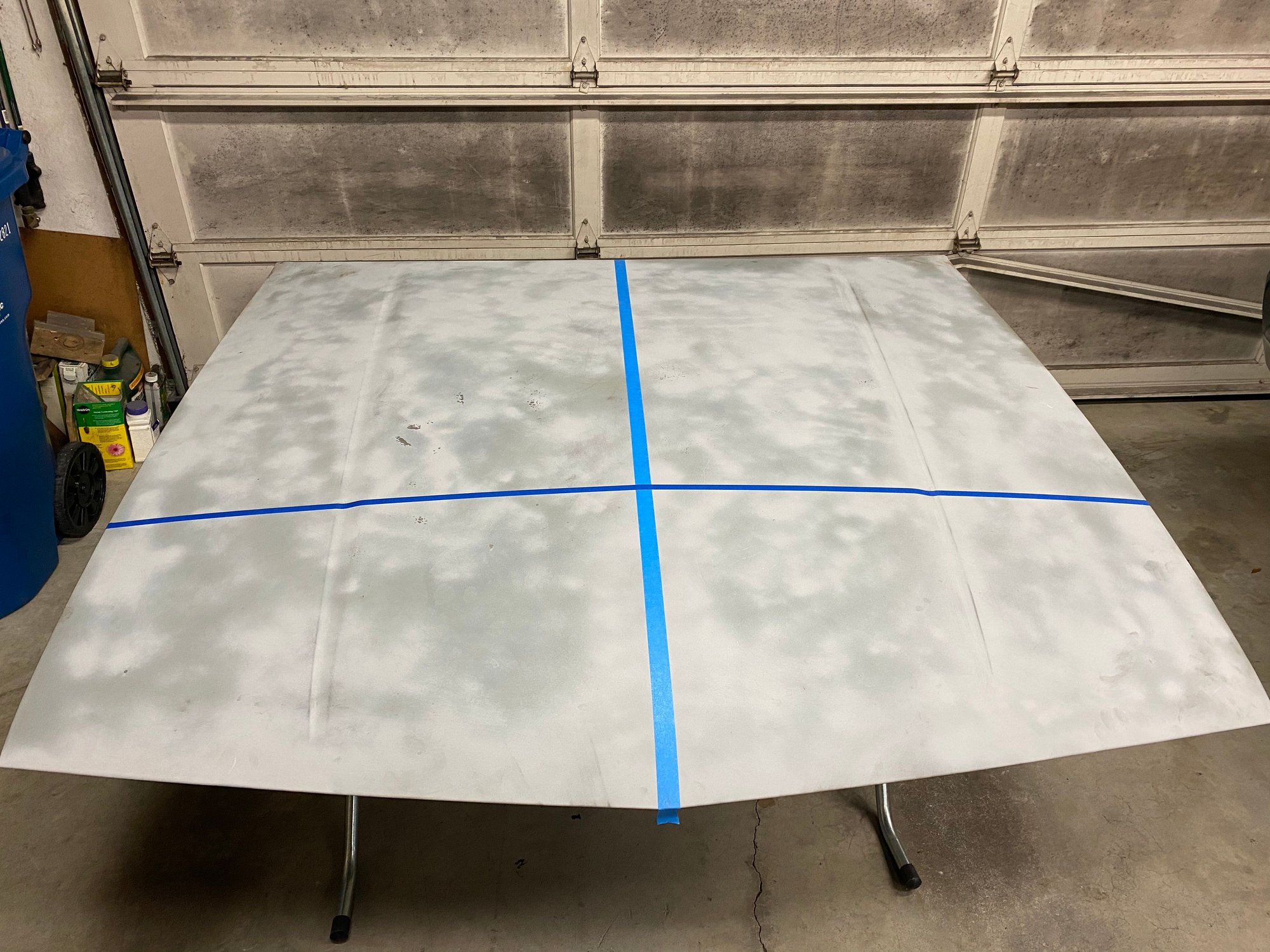

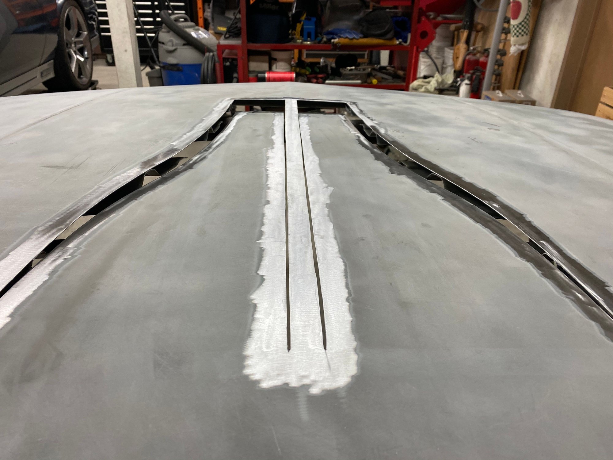

I picked up a flat hood at the salvage yard for $40 to create a unique hood for my Z28. This is what happens when you let the things in your head get out.
Find center

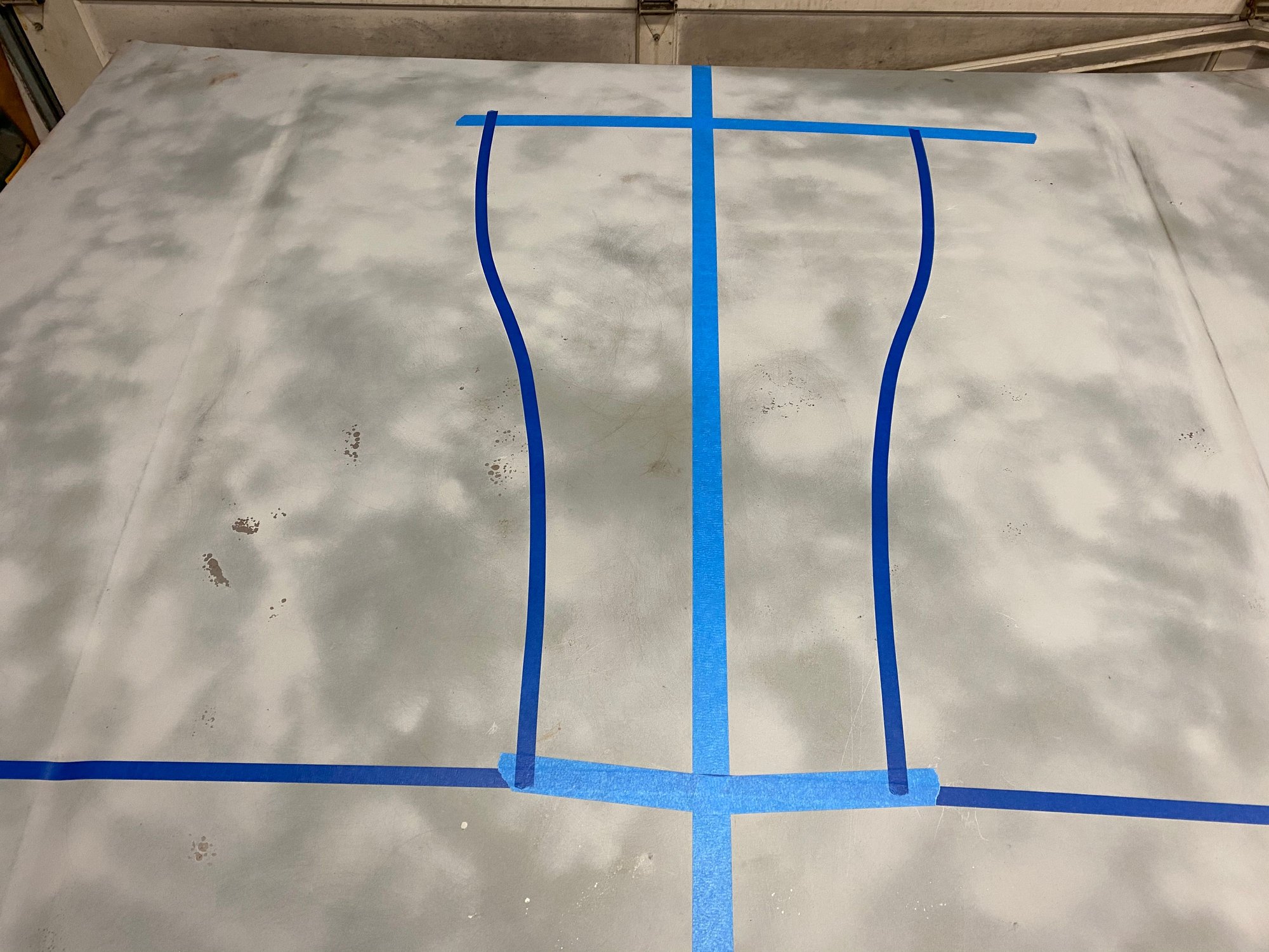

Layout templates

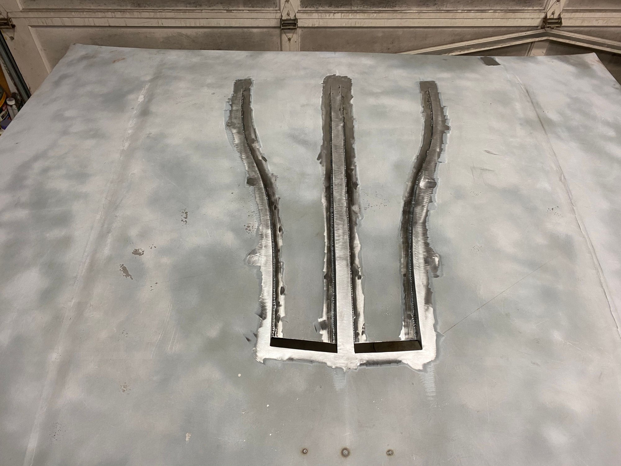

Cut
View from the driver’s seat

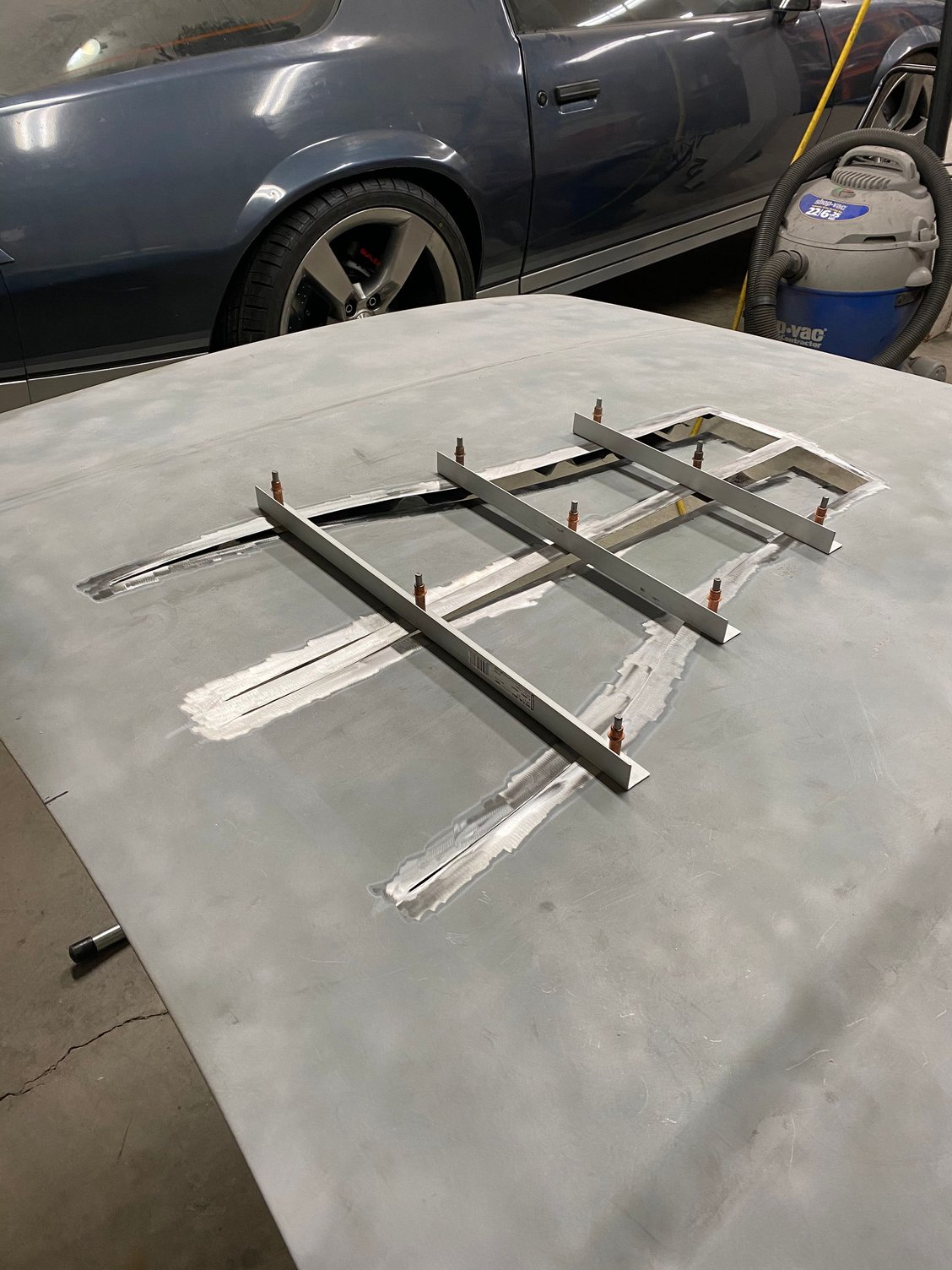

Brace for the center rib

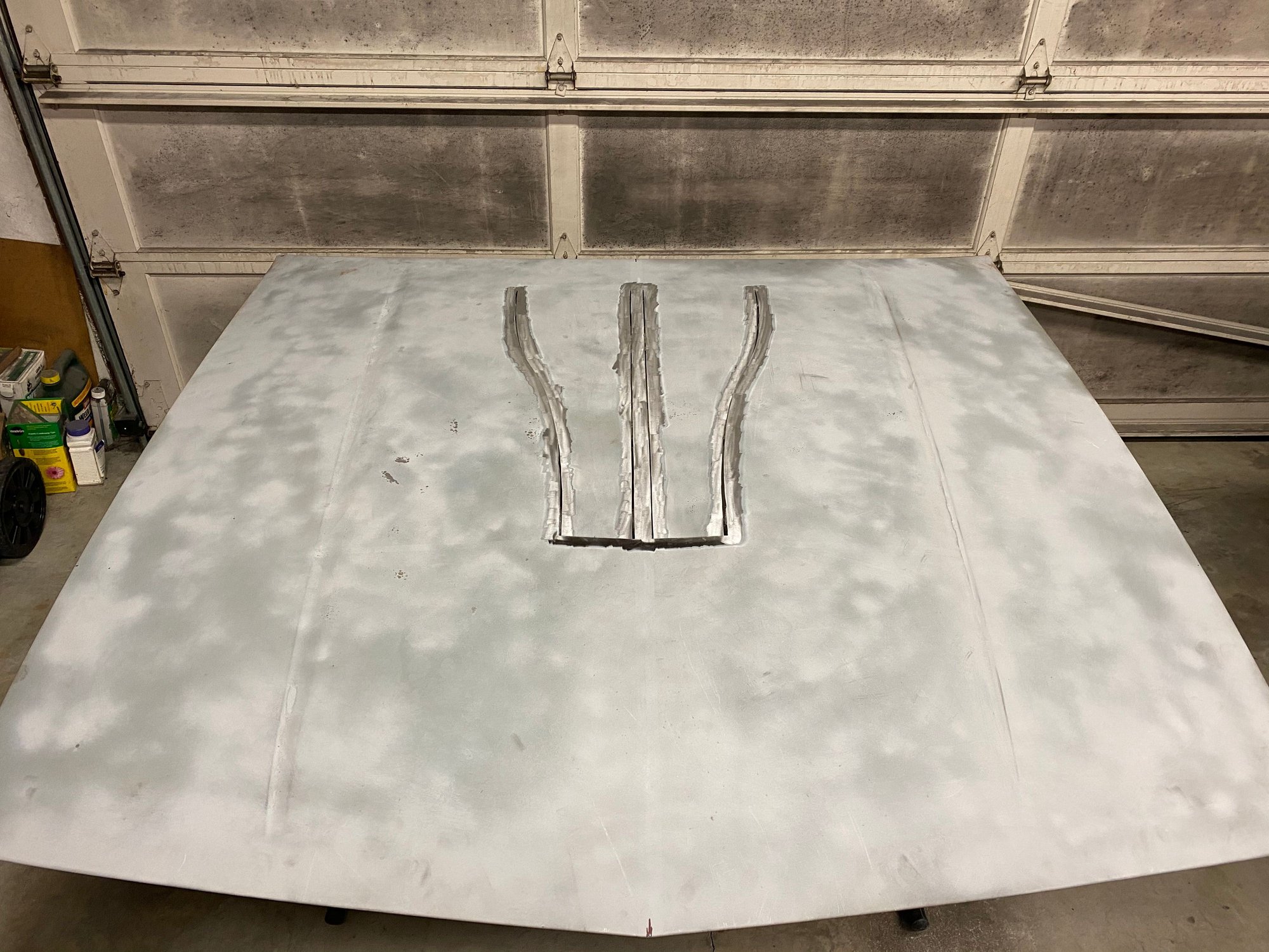

Finished welding, now the concept becomes more clear when compared to the original hood.

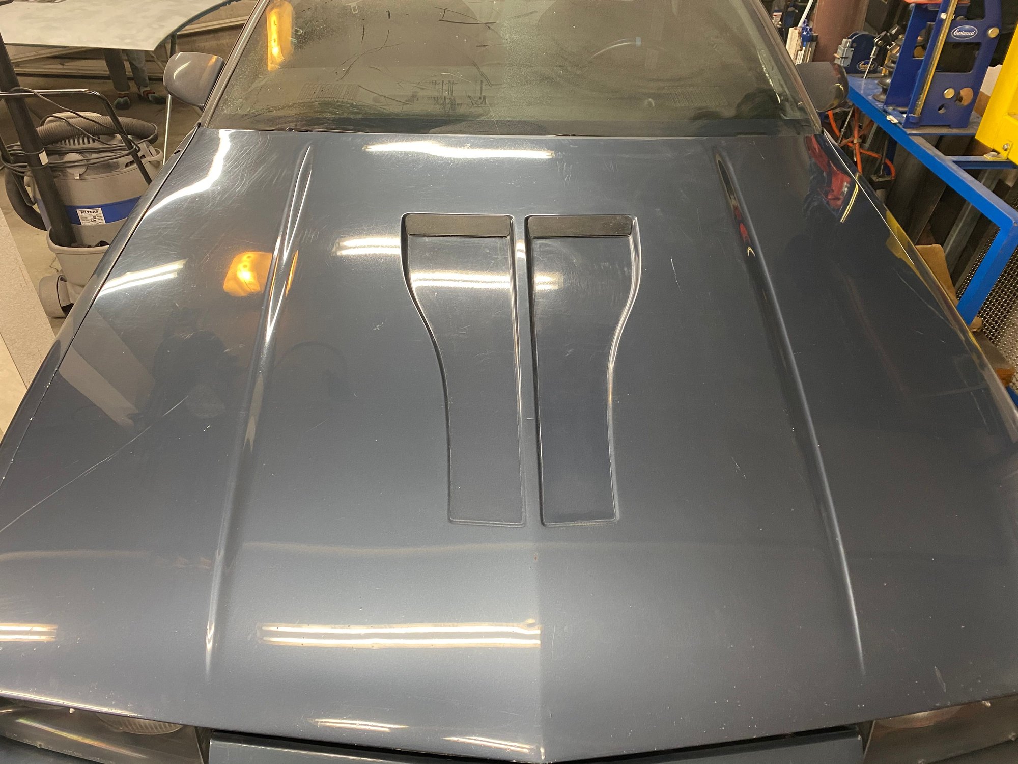

Original hood
Openings reversed
