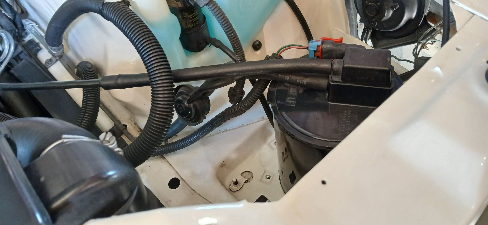

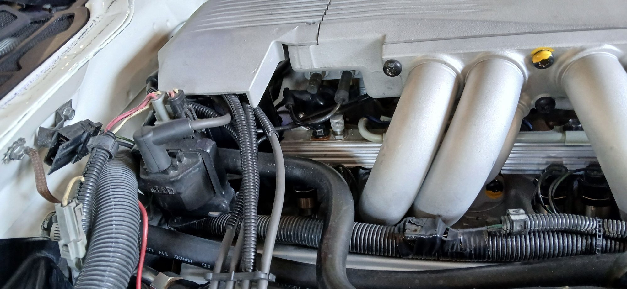

Here is a picture of mine.
As it is a non AC, non cruise, 5 speed it may not be much help. The front port goes to the fuel regulator, the rear is plugged. The unused connector at the base of the rear runners is for AC. If you have an AC car, it is my understanding that the HVAC controls are vaccum actuated.
Mine was one of the first 1LE cars and built for a GM Motorsports racing series, hence the yellow paint sealing the engine components.
Mike.
