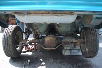

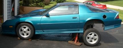

Pics of my old 91, this is how high you need to get it. You can jack the back up by the rearend center section, shore it up by the frame (blocks or good jackstands), then disconnect the lower shock mounts and lower the rearend.
