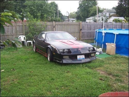

It has been sitting for about 12 years now. There was physically nothing wrong with it when my father started to work on the car. The reason he said it needed a new ignition switch was due to the key falling into the lake while he was fishing.
Currently the only photo i have

So you don't need a ignition switch you need your ignition cylinder re-keyed. I only say this so that if you call for a quote you are talking the right process.
12 years can cause some issues. You need to change oil and drain the gas. You may heed to swap out the gas tank but its had to say for sure. IMO It mostly depends on how much water was in the gas when it was parked. I have seen cars that sat for 15 years and there fuel system where fine and I have seen cars that sat for ten years and needed to replace everything from the gas cap to the intake because of rust and varnish. Your fuel pump is inside the tank, if it sucks up a lot of varnish or rust it will kill the pump. If it was me I would send a bore scope down into the tank after it was drained. to see how bad it looked.
you can find bore scopes that plug into your phone for cheap on Amazon.
If belts and hoses where original or cheap replacements they may all need replaced but if the where newer quality replacement they could be fine for a year or two more. Before you drive the car on the road check all the brakes but first do a stomp test. With the car jacked up on stands or cinder blocks. Press the brake pedal as hard as you can after you get it started, release then push and hold. check for brake pedal fade and get a friend and make sure the brake lock and unlock as you press and release the pedal.
As for the key you should call around for lock quotes from lock smiths. I have done the GM process a few times when I was a mechanic. You disassemble the steering column and remove the cylinder. Take the cylinder to a GM parts department. They can look at how the cylinder is configured and you can get a new key cut or they can change the cylinder to to work with a different key. Then comes the fun part. On the side of the key is a resistor with a OHMs value. One of 16 possible. The dealer had a box with a 12 position switch on it. You would install the box inline . You would put it in position 1 and try to start the car. If it starts then the resistance was listed on the box and you could just tell the key maker that resistance. If it does not start you have to wait 5 minutes then test the next position. Year if you try to start the car with the wrong resistor the security system will disable the car for 5 minutes.
I think I remember people on Ebay selling a full set resistors you can hook inline, That would allow you to not need the box, If you wanted to you can also leave the resistor in place and not worry about the chip on the side of the key.
Doing a steering column and figuring out the resistors is not super difficult but to do it without the proper tools make it a real pain and buying the proper tools could cost more than a lock smith also lock smiths may have developed a better process then we used in the dealership back in the day.
If you know the original dealer that sold the car new they may have the Key info but back then there was no central data base. I kind of doubt any dealer has kept the info that long either way. but it may be worth a call.
