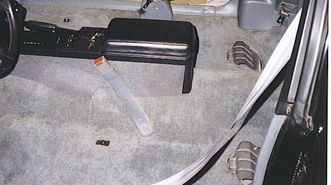

The driver side seat in my 1988 camaro is worn out and stuck in a very reclined position so I plan on removing and replacing it. I have never taken the seats out of a car before, is it east to remove the camaro seats?

Front seats have (4) each 13m nuts on the seat rails---(2) in front and rear.
