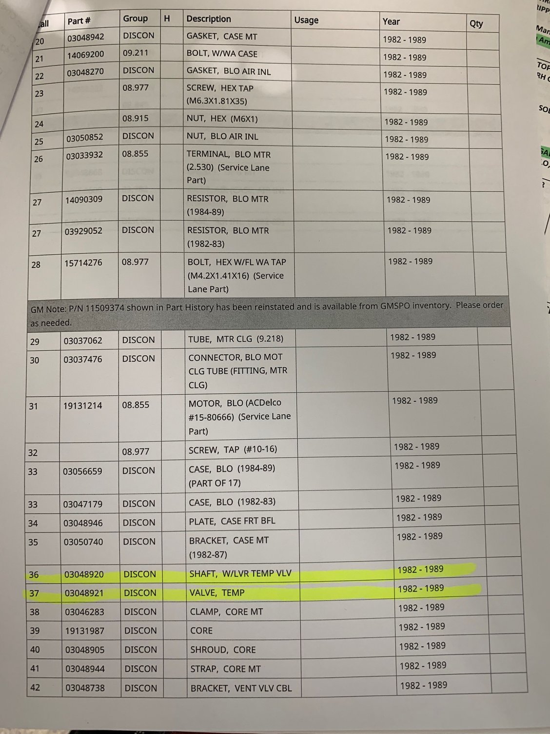

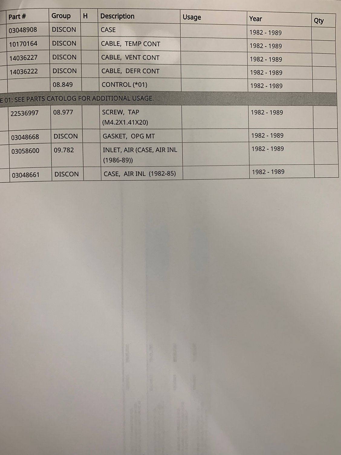

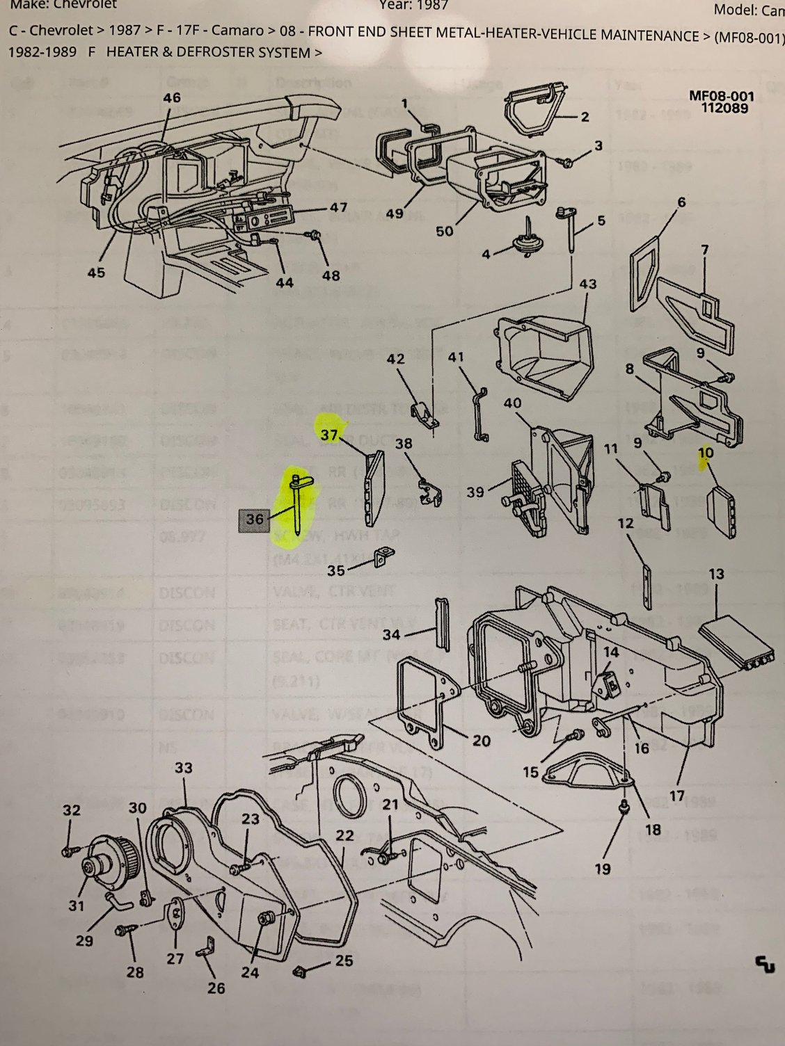

Hello. I am the Merchandising Director at Classic Industries. I looked into this issue and here is what I discovered.
The GM books we have access to do not list this item past 1986. Maybe this diagram will help you?
Perhaps someone else here can shed more light on any information regarding whether there were any further changes to these parts after 1986?
The item you are looking for may be called a Temperature Valve by GM?
If you have images you can upload showing the parts you are looking for, it may help.
Or, if you can use the exploded view, here, and identify what you need by referring to the number in the illustration, it might clarify what you need.
All the parts highlighted with Yellow highlighter on these pages are obsolete by GM. I could find nothing used or NOS on Ebay or in a Google search.
