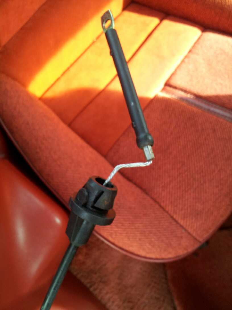

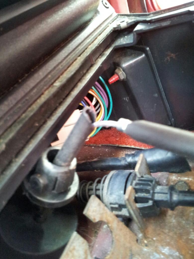

RonnieJ86's Avatar
Joined: Mar 2012
Posts: 164
From: Maryland
Here are a few pictures of the 2 cables. The one installed is the new one from camaro central and is pioneer brand and the other that's being held is from when the trans swap was put in on may from advanced auto, not sure of the brand for it. And my friend said that the shift linkage moves easily with no binding and the routing was normal.
