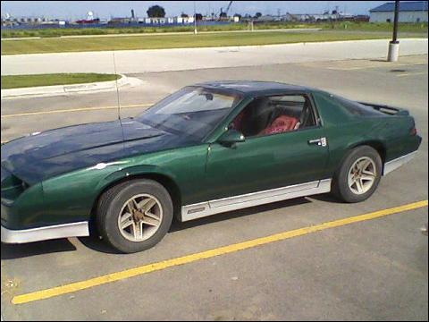

Yes power seems a little lacking. From pushing on accelerator to actually getting the tiers moving seems to be quite a lag, the motor doesnt bog or anything, it just seems to take awhile for the power transfer. But the main reason is because i like carbs, i like the adjustability, and plus it just looks nicer when you open the hood. I have a good lead ($300.00) for an edelbrock intake and carb together from an acquaintence. but before i buy it i need to know how much electrical is involved, If it means needing new ECM and a bunch of other stuff then it is not really worth it at this time, i could take that maney and replace other things the car needs (like shocks and struts) rather than just getting something i want, (Carb and then new exhaust).
