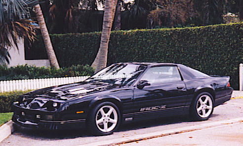

I think you are making a good decision. I have owned mine since it was new in 1987 and I can name the parts I have not replaced easier then ones thaI have. Yes, I drive year around in Florida.
