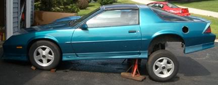

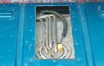

Below is my 91. I started out going the hatch way, so that pic should give you a good idea of what you'll be looking at. Those steel lines run across the left side of the tank, then drop down, without a break.
I cut off my old exhaust (needed to be replaced anyway) and lowered the tank a good amount at first, seeing if I could wiggle the sending unit and attached lines assembly out. Absolutely no way that was going to happen without cutting the lines. Since I had the tank most of the way out at that point, I figured dropping it would be no more work than cutting and flaring the lines to reconnect. Jury-rigging (in my estimation) the lines together with rubber wasn't an option for me, considering the connections would be tucked way up out of view to spot a leak, not to mention being above the exhaust. The supply lines are flared from the factory for a reason, and I didn't want to half ars my car, just to save a little time.
The hatch technique works a lot better on the 4th gen's because they have disconnects on the lines up there.

The '91 is running today! We cut in the access door, and then pulled the ring off the tank to allow the sending unit and pump assembly to be raised a few inches. Then using a little push style hacksaw I have we cut each line by hand on either side o those 90 degree bends. Once we had it cut loose, we brought the assembly up, and saw the badly rotted out connector hose you mentioned previously on your car.
We replaced the pump, strainer, and hose with new ones, and dropped it back in. The pump was too cheap not to replace while it was apart; only $40. Then we made up an access door cover and put it over the hole. Started it up first to check for leaks, and to see if it ran, and all is well! Purrs like a kitten, even with a 5"-6" hole in the muffler!
Thanks for the advice and help Chuck!

We cut the lines just before the 90's, and just after. Then we spliced it back with fuel injector hose, and high pressure clamps doubled up on the pressure feed hose. The other lines got single standard hose clamps. We were able to get a nice gentle bend in the hose, so nothing kinked, and it all laid down nicely.
