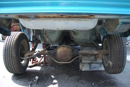

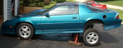

Eh boy! Yep, if you hear the pump run, and gas is dribbling out before the filter, you're going inside the tank.
Here's pics of mine, and what yours is gonna look like in order to drop the tank.

Not out, and not disconnected. After you disconnect the shocks, the rear axle will pivot down like that once you get the ars end of the car up. And you'll be able to pull the rear springs right out as well, which you have to do on the passenger side to clear the tank as you drop it down and at an angle.

Oh yeah, you have to remove both horizontal bars in back too or the axle won't lower much.
