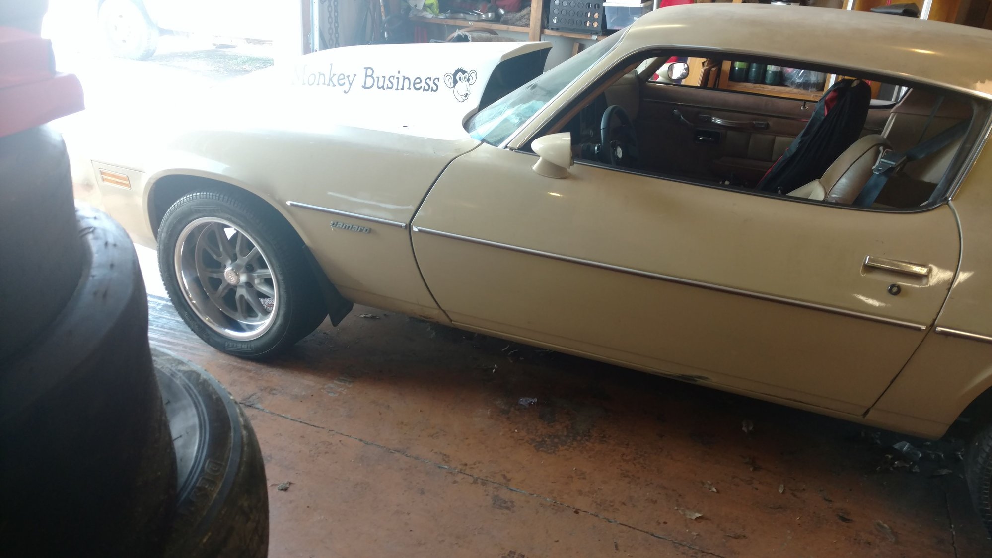

I have a 1979 Z-28 RS Camaro ,When I bought the car it had 15 x 7 Appliance "Turbine " wheels on it.with 235/60R-15 on it and have put a 245/6015 in the rear ,I have run a 16 x 8 and 17 x 8 wheels on it now. With 245/45 17`s front and 275 /40 17 rear on a 17 x 8 wheel with 5 " of back spacing.with no rubbing. So it depends on what backspacing and tire bulge you have,At the very least yo might have modify the outer wheel will lip.because of what tire pressure you go down to.
