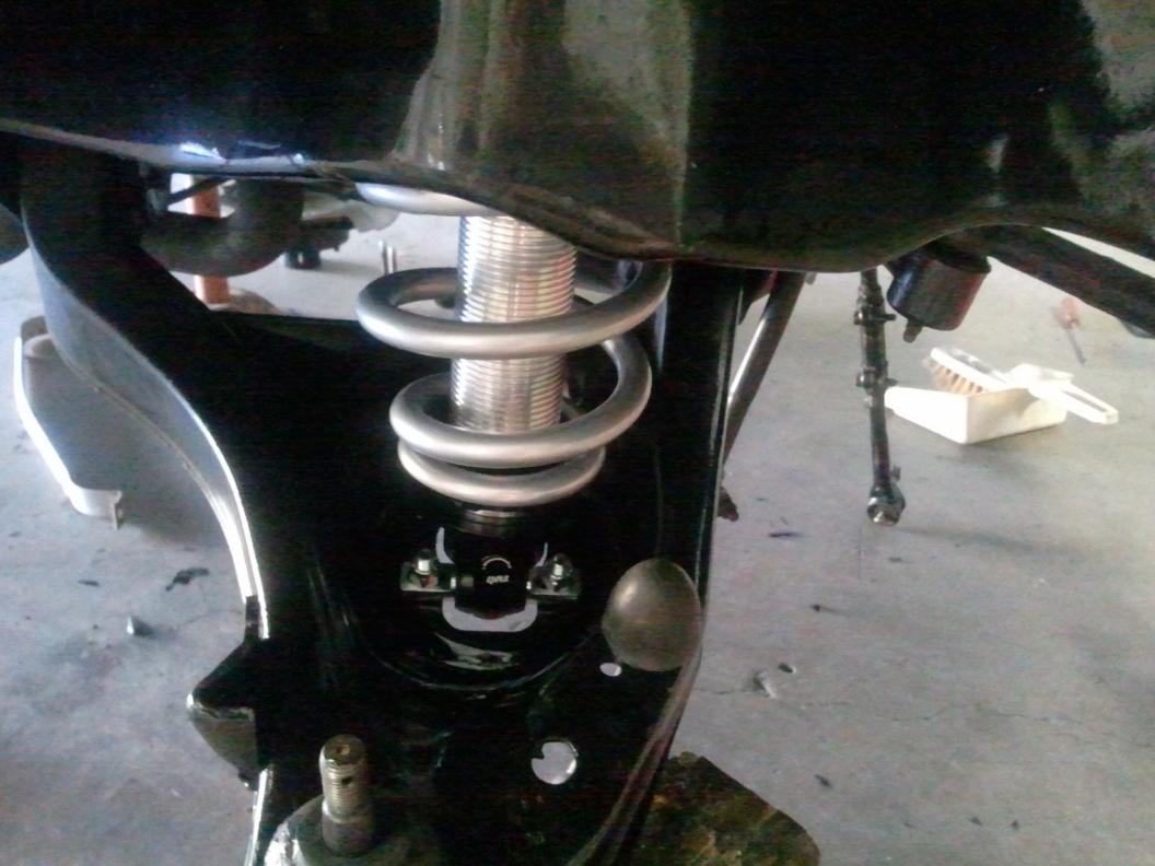

They do ship to Aus, I will look into that before I get ripped off blind here, I got a QA1 front procoil setup a couple of months ago from them, and it was only $98 shipping
