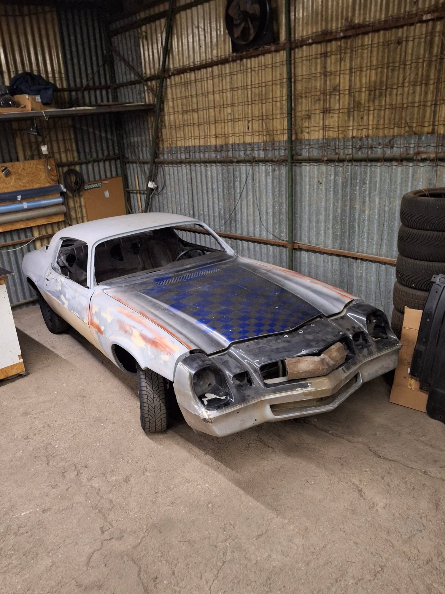

I bought a 78 camaro with a 350 engine which was completely disassembled by the previous owner.

you could go with a cop cams XE262H it has a strong low end torque with a good sounding chop. for pistons id go for a flat-top hypereutectic (speed-pro H345CP). i would love to see some pics of the camaro never seen one in the Czech republic best of luck!
