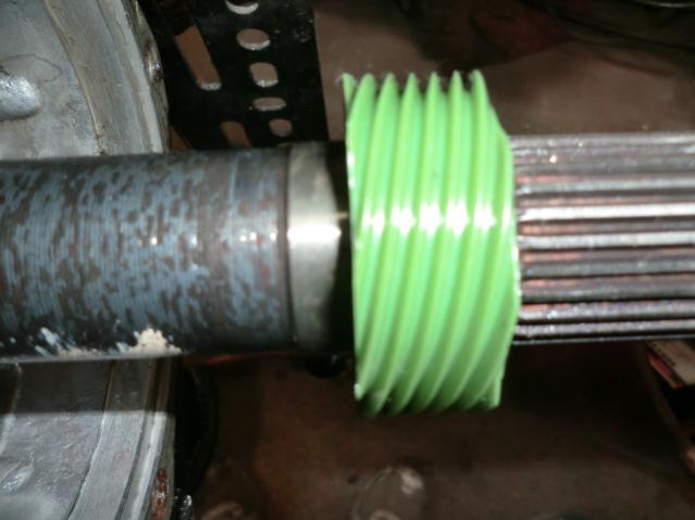

SO right now I'm sweating the speedo prob. I've found lots of charts for gear changes all over the net.Not too simple. How do you count teeth on the drive gear? Straight across? I count six!! There is no 6 on the chart, chart says green is 9. I can go diag and get 8?

Well I figured that out!! From the end, count the beginning of each spiral.Now to find the correct driven gear.
Looks like a 25 driven with 373 and 255,60,15 tires
