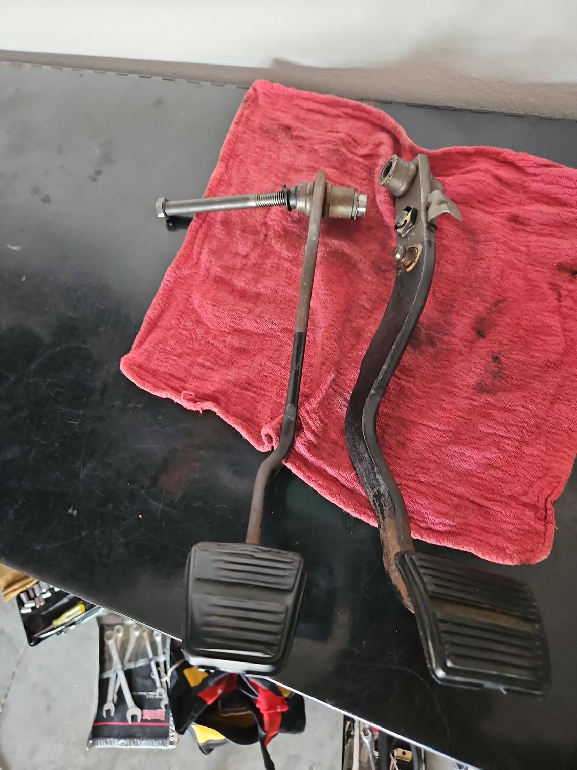

Got the Z-Bar rebuilt and back in the car. Much smoother pedal but something was still "off". After ripping out the seat and diving under the dash I saw a broken neutral safety switch dangling from the pedal assembly. It then wiggled its way into the clutch linkage and caused all kinds of binding/jamming issues. Popped that out (it wasn't working anyway) and noticed that both the brake and clutch pedals are super wonky. Looks like the plastic bushings are toast. Any recommendations on kits to rebuild these? Or will any old set of bushings do?

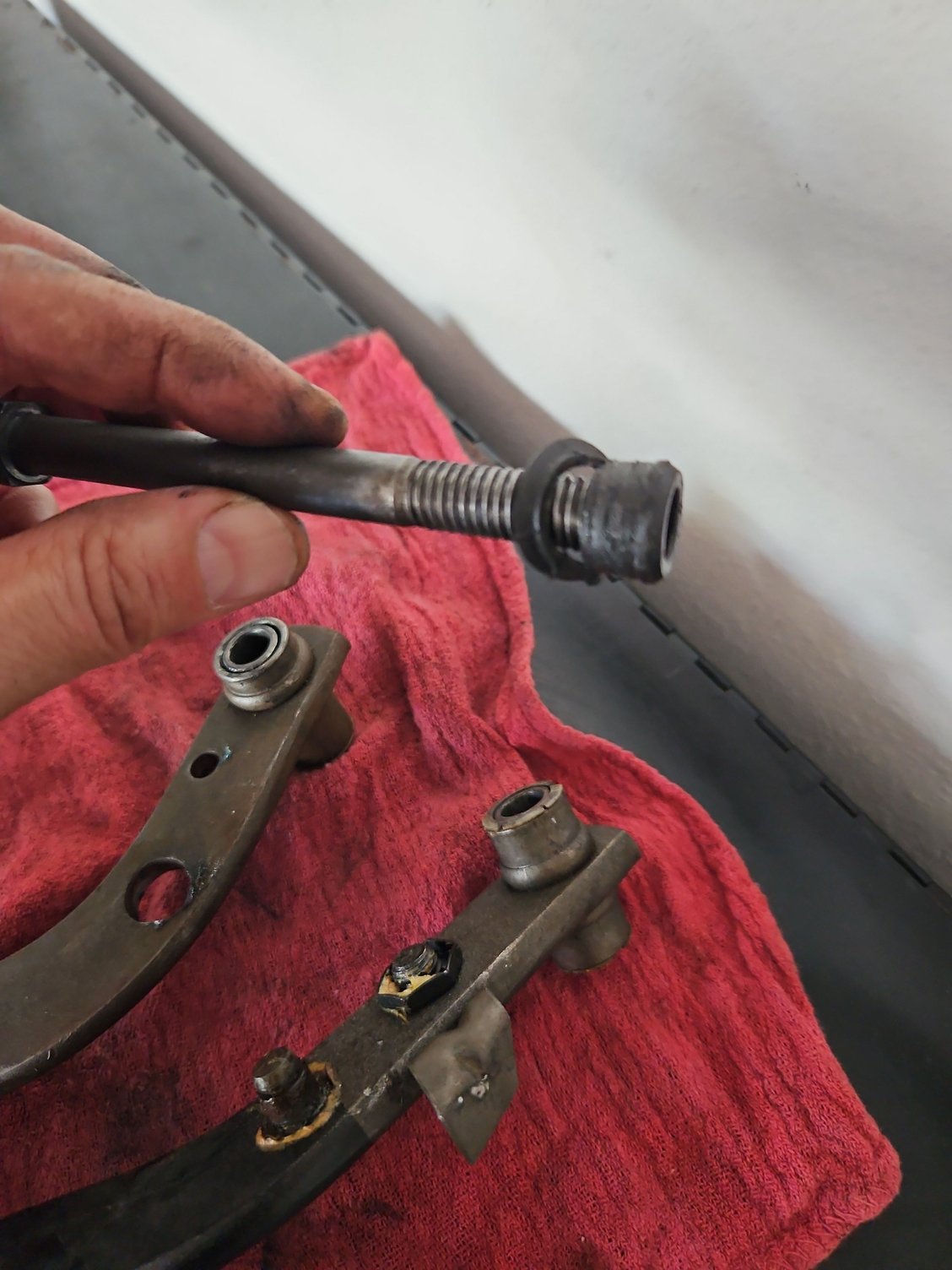

Got the pedals out from under the dash. Numerous upside-down ventures and a few cuss words revealed that the bolt washer was installed with the nut instead of the bolt head and allowed the bolt to free-spin inside the clutch pedal sleeve when trying to loosen the nut.
