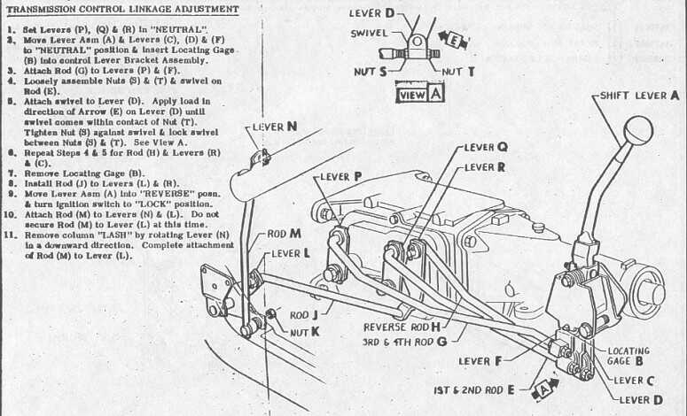

Question 4 Speed Saginaw Transmission HELP
I have a 4 speed saginaw transmission in my 1970 Camaro and the linkage arms are messed up...does anybody know where i can get a picture to compare so i can fix it?

Here you go
Attached Thumbnails 4 Speed Saginaw Transmission HELP-docmuncieadjustshifterjv7.jpg
