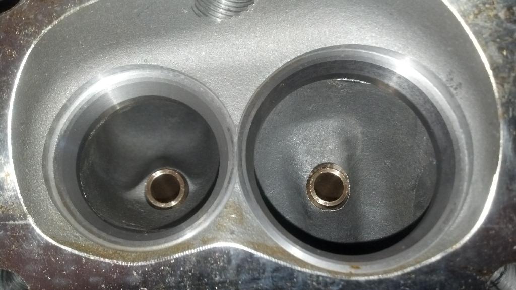

Now the heads. I answered an ad for a new, bare set of 190cc 2.02" valve 74cc heads. The seller was clear when he said he had a set of lightly used valves he would toss in and a set of springs that were used with the valves. So I figured for $375 shipped I would grab them up. The only reason I wanted them is for the big chamber. I searched out the flow numbers and they have great peak flow but kind of poor low-mid lift numbers . I had never heard of them sold with large chambers and the seller said he was told that they were exactly the same as the smaller ones but milled more. I was hesitant on that because it makes absolutely no sense. Having different deck surfaces on the same line of head? When they came I commented on the holes. I was a pissy but worded my e-mail in a completely profession manner that in no way blamed the guy. I just said I wished he had posted a pick of the holes because it would have been a deal breaker. I also questioned the chamber. BUT I explained they only LOOKED small, not that they were. So he goes back to the original seller and tells him. The reply was forwarded to me. I was made out to be a dummy. "I obviously havent seen very many aftermarket heads because it happens all the time an is normal." Really? I havent seen any AFR,Brodix,Dart, Edelbrock, or even my Canfields with these holes. I have never heard of anyone buying heads that came with a disclaimer to epoxy any holes in the intake runner. I understand them getting into water. Pipe dope goes on all my studs for that reason. But to seal the studs to keep oil out of the combustion chamber is stupid. I was given the standard "its under vacuum any how" line. My reply was "I bought these with big chambers because I was putting them on a turbo charged engine." I went on to explain that most epoxies arent safe with alcohol and E85 was also on the table for this engine.

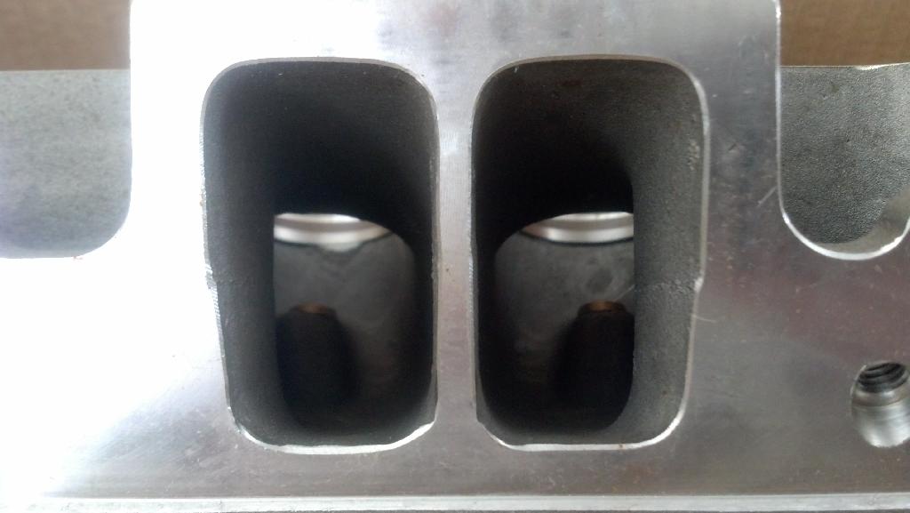

In the end I got exactly what I paid for. I'm not real bummed because I will make use of them. I am bummed that I didnt get the deal I thought I was getting. I didnt check pricing before committing to buy. I could have gotten them off EBay for $400 shipped. But I have a set of used Manley valves and I believe Erson springs. Whoopty doo! Here are some pics. There not bad looking castings at all.
Chamber
Didnt Tony have some typ of deal where he found the runners were raised .100" too? I'm not real sure. I watched the videos but I cant tell what ones are yours and what ones are the guys in Denmark or where ever.

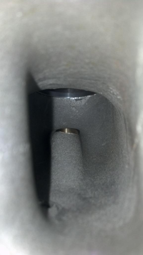

This is the intake runner where the bolt hole pinch is. When I compare this to yours, there is significantly less material in mine in that area. The "pillar of power" doesnt exist.
Chamber

Last edited by 77nomad; Mar 9, 2014 at 03:32 PM. Reason: after looking again I found the bolt hole pinch is the same.

From the pics those heads look pretty good. You're right, the pillar in the runners does look smaller also. That's why I was asking about the numbers up by the valve cover rail, wonder if the production year has anything to do with the castings being so different. The .100" raised runner was on the 210's not the 190's but I don't think it's all of them, not sure. Procomp has quite a lot more sizes/styles of heads than I was ever aware of. I looked on their site (which by the way was bought out recently and the name changed) and there's dozens of different head sizes to pick from along with their cnc'd ones. One thing I'm confused about regarding the 74cc chambers created by milling them is wouldn't that make the chambers smaller and not larger? I'm most likely wrong but if you cut the deck down wouldn't that decrease the cc of the chambers? Have you threaded a spark plug into them yet to see where they end up? That's where the bulk of the extra cc's were created on mine, removing the extra meat so the plug would not be 3-4 threads shy of reaching the chamber. I don't think the PC's are the only heads to have the rocker stud holes go into the chambers either. I've heard of the Edelbrock, Dart, Tick Flow and Patriots doing that also and I really didn't think it was an actual problem but that's where my lack of knowledge comes in. I've seen so many Youtube videos when I was looking into valve lash/roller rocker adjustment where the guys say to make sure to use sealer on the rocker studs to keep oil out. I just assumed that was normal with aluminum heads. I used sealer on mine, even the stud holes that didn't go all the way through lol!
