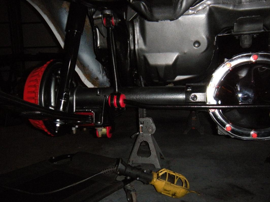

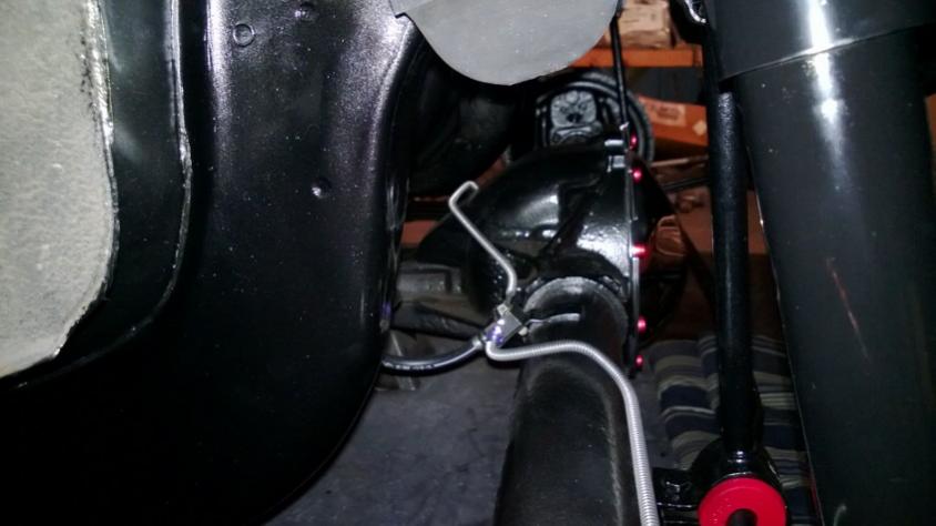

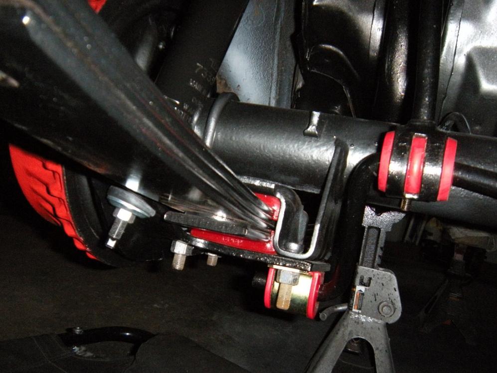

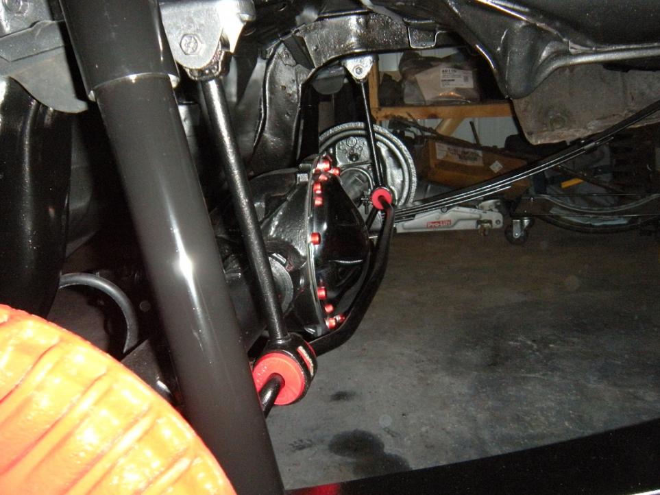

Fixed! At least it was one of those easy jobs to fix it. Got the sway bar finished and got the shocks in there too. I didn't get a new clip with the new brake line so I couldn't get that finished today. I have obtained a new clip and all that's left is to throw the new brake lines in back there and the tires are going back on. Finally!

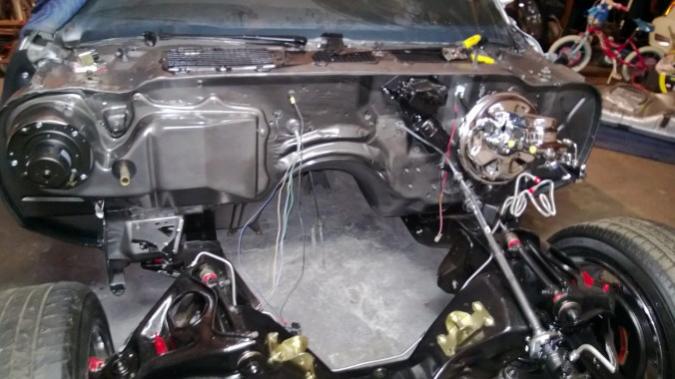

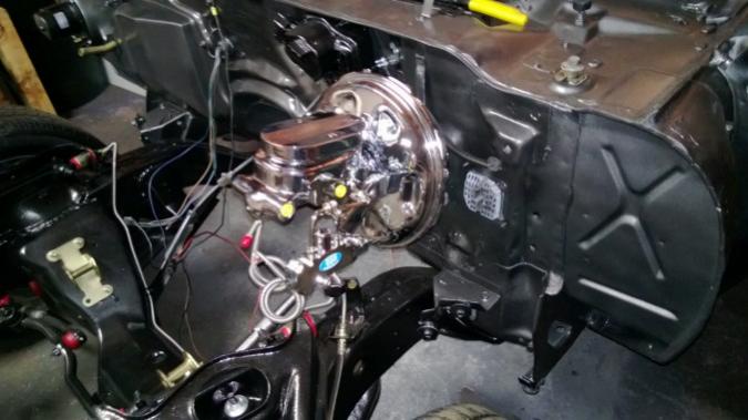

Progress pics.
Appreciate the comment paperairplanes, like the username also! Not sure if there's relevancy or not but just got done making some paper planes with my kids this evening! I used to make some killer ones in my day too lol.
