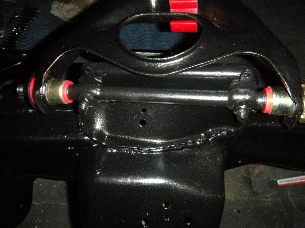

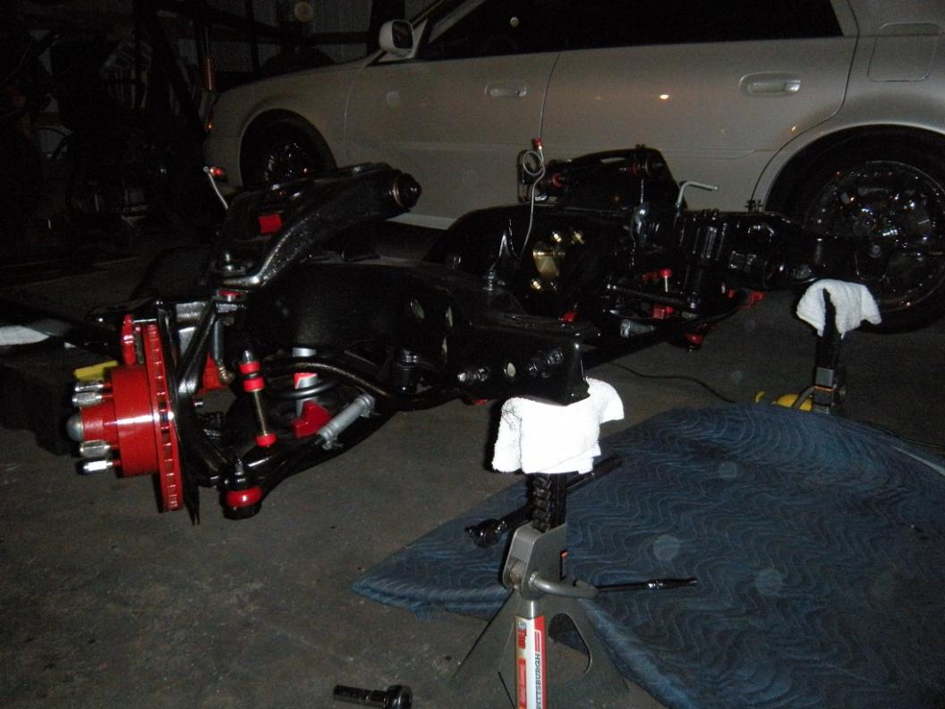

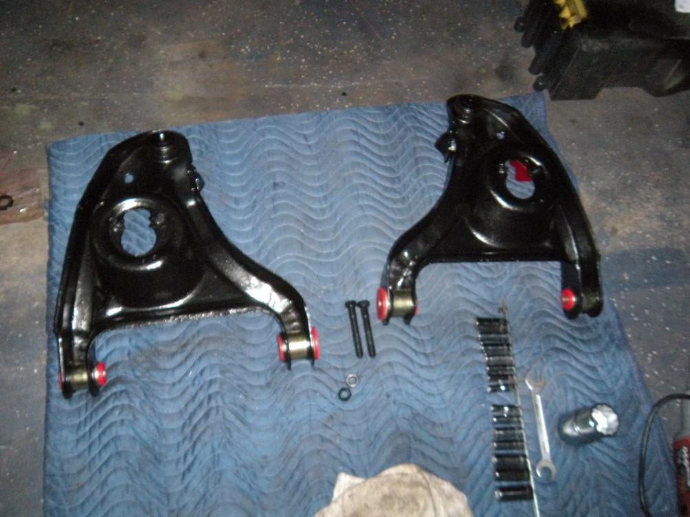

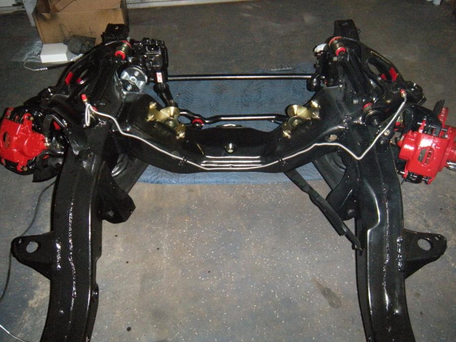

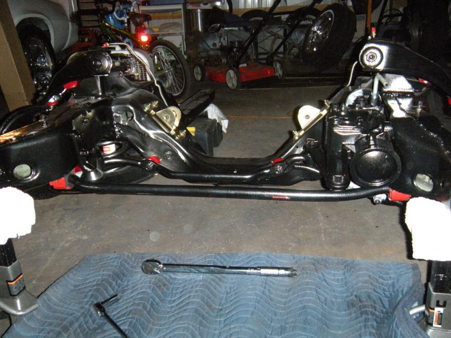

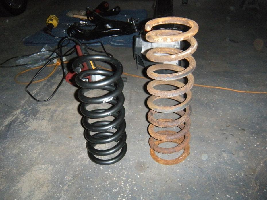

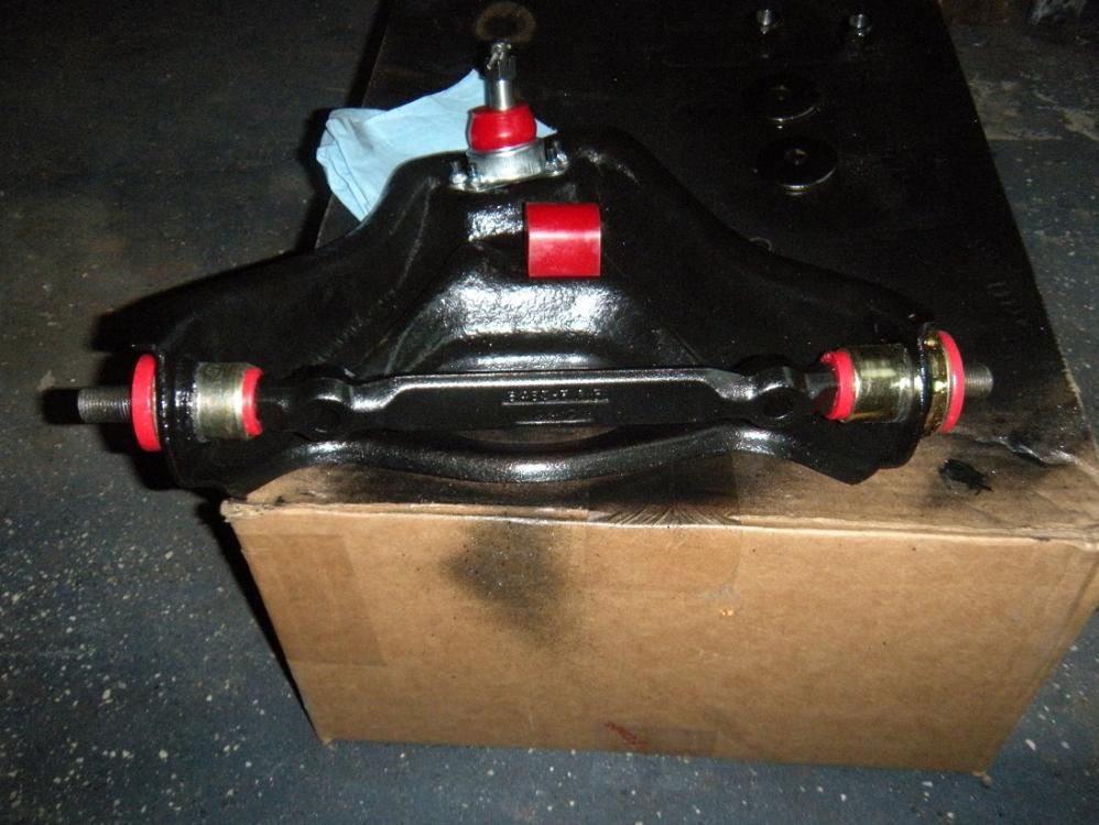

Nothing too crazy, just a few progress pics. Finally got the CA shaft that I waited for almost all week to get. Should've kept my mouth shut about shipping times apparently. Anyway, got the lower ball joints pressed in and the bushings are all in as well (had to wait for the new shaft.) Things are going together nicely and I can't wait to see how the stance is with the new springs. After I put the 18" rims on (before disassembly) the back end had a perfect stance but the front was absurdly high. Should help at least a little. All I'm waiting on is the stainless brake lines to get here and I'll have the front end DONE! Need to make the bottom of the body a priority here this coming week and get the wire wheeling done as much as possible. The humidity is here with a vengeance and I'm not really looking forward to that job. Have a question (surprise surprise) about the leaf springs. I'm almost certain that I'll need the help of a press to change out the bushings. Is there a home remedy for doing the bushing removal/installation minus a press? Never would've thought that putting the CA bushings in would be so tough, but they were!

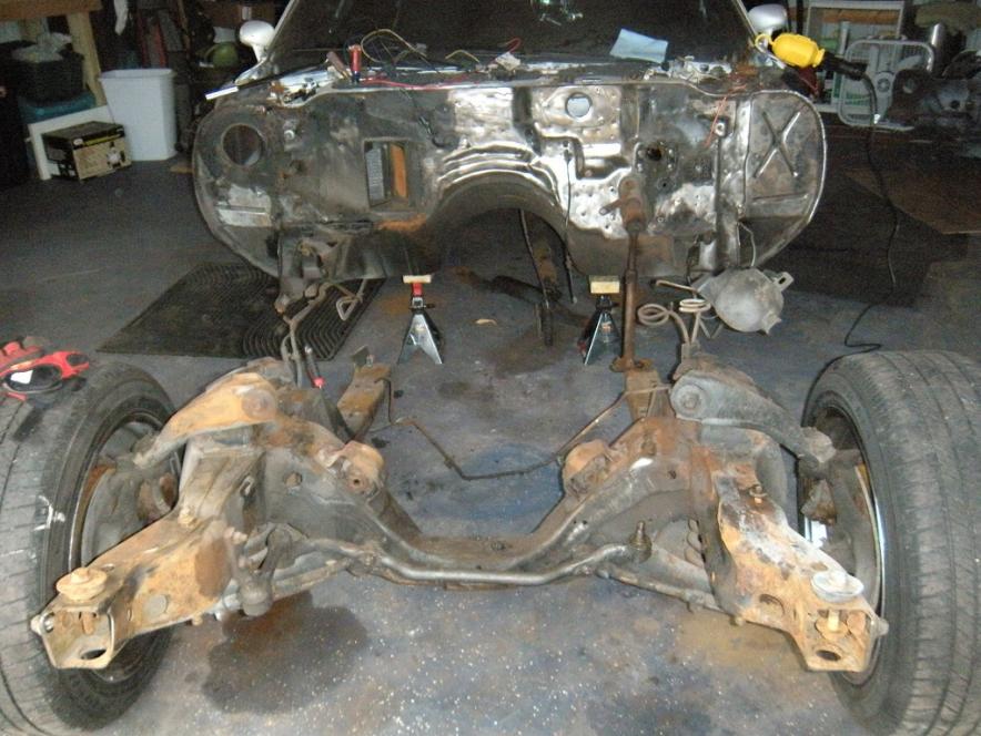

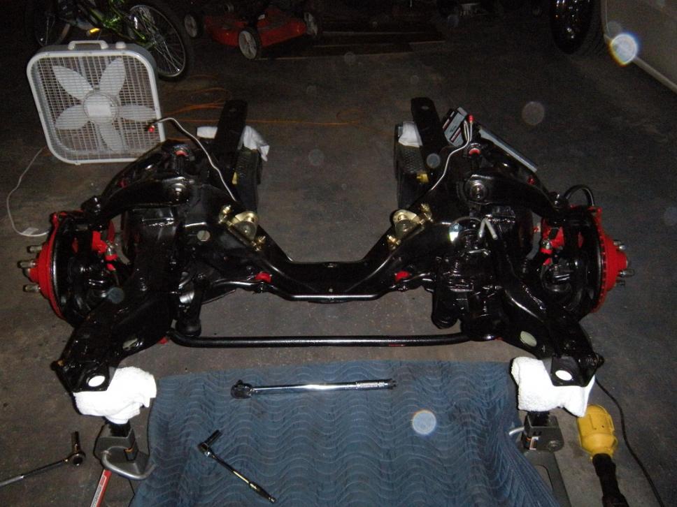

I found 'em all Vall, each old hydraulic hose had one rusted/welded to the fitting on the end. After I took a wire wheel to them they each came off and cleaned up nice. Wanted to share some before and after pics of the front end finished up. I'm quite proud of how everything turned out. The rotors cleaned up much better than I ever thought they would and, well, everything did for that matter. The bushings, shocks, steering components and brake lines are new, everything else got wire wheeled and painted. Need to get some blankets on the front end now, everything's all dusty already! LOL I'm getting at it with the wire wheel underneath the Camaro now trying to get the bottom of the shell done and remove the gas tank, rear end, springs and fuel lines so I can get everything back there painted and put back together. Keep thinking of the time I could have saved if I only had a media blaster. Making progress though - slow and steady. Not sure what else I can do now as I've tried 3 or 4 times but I really wish I could've gotten the pitman arm up onto the shaft of the gearbox a little more. The nut is flush with the bottom of the shaft at least. I forgot how close all the steering "stuff" is to the frame as well as the rag joint but nothing hits anywhere when I turn the spindles side to side. The hard brake lines were supposed to be pre-bent and they are, just not in the correct spots! Thinking I might send them back and try for a set that has the bends in the right spots as I don't want to mess around and screw them up now. That's why they're not connected yet. I'm sure it would be easier if the frame was back in along with the booster/MC/prop. valve but it's glaringly obvious. Other than those, the frame is ready to get back in there!
