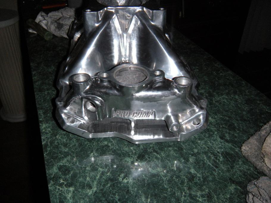

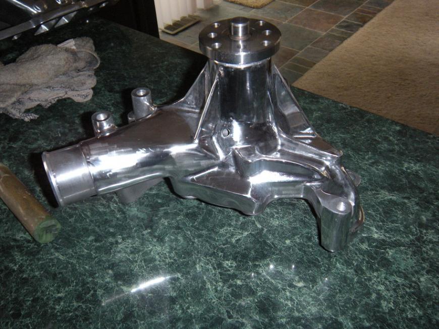

Ironically, both my balancer and fan take fine thread. Just bought some chrome cap screws 5/16 16 and they won't work. My fault for not checking first. Couldn't find fine thread 3/8 for the balancer at 3 different places. I have the original bolts from the balancer so I know they're fine thread. Guess I'll have to order some from somewhere.
For what it's worth here's a couple pics of the before/after on the WP and intake (re) polishing. This is before I got the residual compound off but you should be able to see the difference. Look by the name on the front of the intake to see the difference the best.

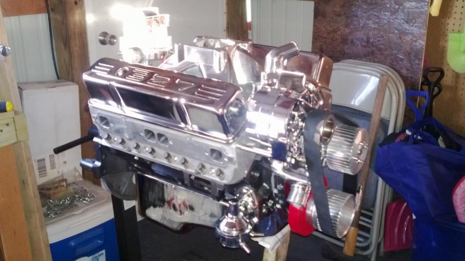

Made some progress today and I'm proud to say (after 3 different attempts at getting the right sized cap screws) that the pulleys all line up beautifully! I was worried about the balancer pulley the most and ironically it's the one that could be spaced outward a tad if anything. Don't know what the deal is with these pics after I resize them but after I do that, they look all cloudy. Oh well, it's still a 327!
Question for you Vall - how did you tighten the alt. pulley nut after putting the new pulley on? I can't use a wrench like I did to remove the original pulley and when I use the socket, I can't get the allen head in the center of the mounting stud? Don't want to go bending up the fan by lodging something in there to tighten the nut. Just curious sir.
