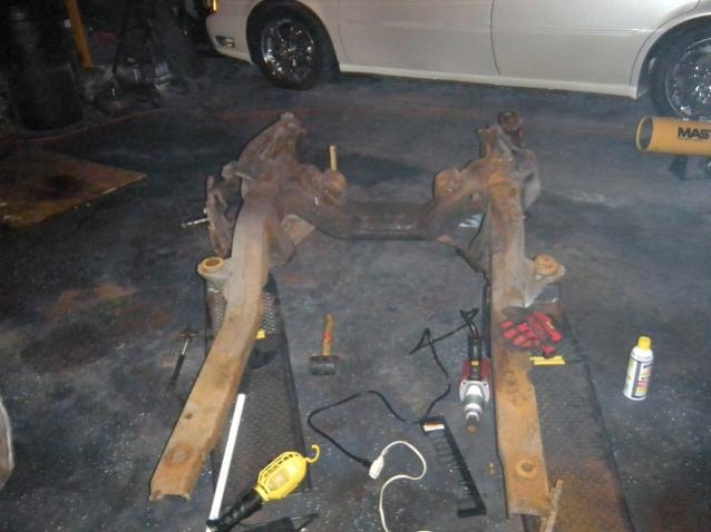

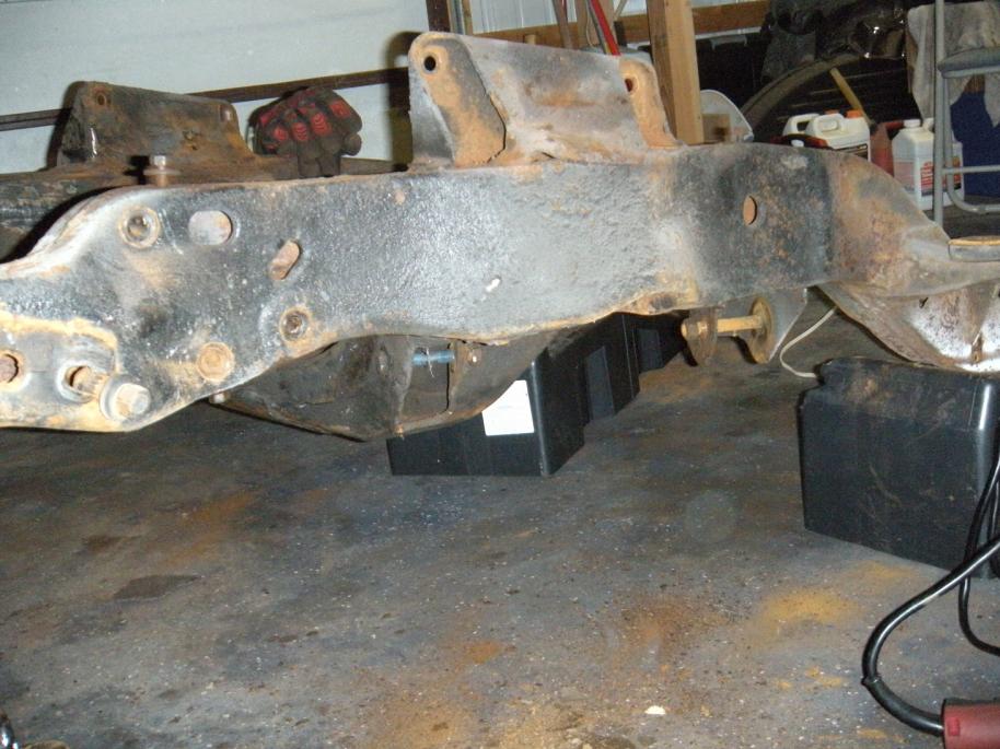

Happy February (and January's gone!) everybody, i'm trying to keep true to the project title and capitalize on the days where it's above single digits in temp and whittle away at the front subframe. The heater is the only thing getting miles put on it these days around here. I was finally able to get the subframe stripped down (first time spring removal by myself with no weight.) No problems other than one of the lower control arms mounting bolts was really seized in there! I put a pic of the 2 bolts and you can see one of them is literally like the day it went in (in '78) and the other is a little "discolored." I had to beat on it with a 3lber for almost 10 minutes before it came out. Also, would love to hear any tips/tricks to getting the motor mount pads off the frame EASIER than it was for me?? What a setup that is....
