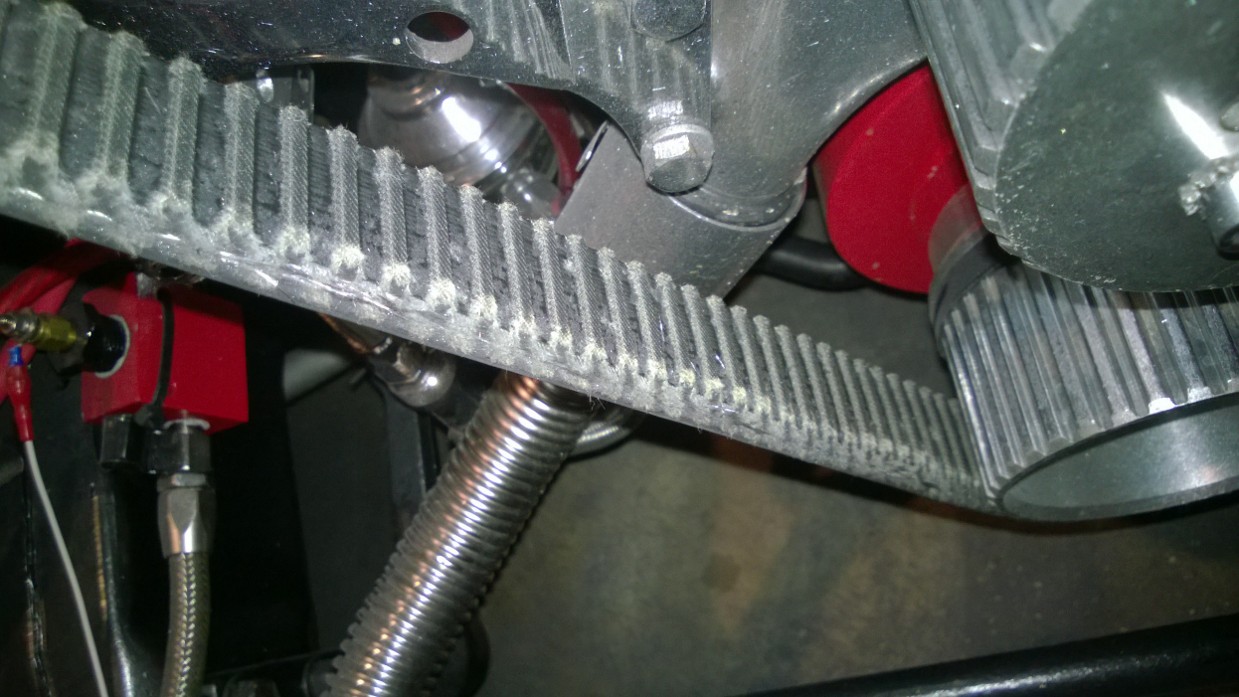

Strange deal here. So the Gilmer belt has decided to start walking off the end of the alternator pulley?! The belt is NOT misaligned, there's absolutely plenty of space for the belt on both the crank and water pump pulleys and . Look what it's done to the belt? This just happened tonight and I didn't even know it had come off there until I got back home and things were a little bubbly in the radiator. Aren't these the belts that are supposed to NOT fall off? Guess I better get busy and get a new belt ordered.

The belt can be perfectly aligned, but if the alternator is even slightly cocked, it will try to walk off and tear up the edge. The alternator also needs to be rock solid, or engine torque on acceleration will try to pull it sideways, and also eat up the Gilmer belt. As I mentioned previously, I dumped mine after 3 belts, and numerous attempts to try and make it stop eating the belts. Not to mention the rubber dust all over my engine bay!

It must have something to do with the engine torque while driving as it's always been perfectly aligned on all 3 pulleys until now. Got a new belt coming but for now I think I'll flip the belt around and try to pay closer attention to what's going on with it.
