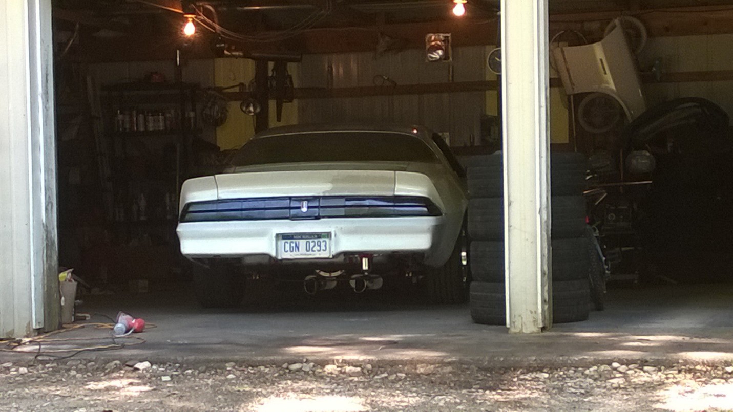

Appreciate the comments sudstoy and clacia, it's quite a triumphant feeling to make that first drive after having the entire car torn apart for so long. Wish I had a chance to drive it more since then but it's been a hectic week. Holiday festivities this entire weekend left me zero time to do anything more. I did learn that the #6 plug wire melted a bit on the header tube when I drove it that evening. I started the engine before we left town so I could switch stalls in the garage and it didn't want to idle properly and seems sort of lethargic when I tried to rev it. Not a big deal, ordered new plug wires (yep, another set) but probably won't be here until mid week. I'm going to try and finish up the front end the next couple days while waiting out the delivery of the new wires.
With the exhaust, I'm pretty much expecting there to be droning regardless of which mufflers are on there. Not having the pipes all the way out after the mufflers doesn't help with that noise/sound much either. Think I'll do some looking around this evening once I finally get a chance and hopefully get a decision made on what I'm going to run next. Shouldn't have any trouble selling the flowmasters since they don't even have a scratch on 'em. If I get $100 for them, that'll at least help pay for one of the replacements. No big deal. Sudstoy, while I agree with you about prioritizing purchases for this Camaro, it's just one of those things that bother me to the point of escalating the "want" to "need" because I dislike the sound of them that much. When I first installed the flowmasters, I almost didn't knowing I would not want them on there but at that stage, I was in agreement with your philosophy. Wish I wasn't so picky about the sound as I'll most likely end up doing this several times before I'm satisfied. I'd have to assume most everyone feels the same way about certain aspects of their cars and this is just one of those things for me.

Yeah man for sure, its your car and you have to build it how you want it. That's the best part about building them in the first place! That first drive is something else isn't it? Crappy deal about the plug wires, but at least they don't cost an arm and a leg. First thing i busted on mine was a flaming river steering box and i think its because it got tightened up too much in install, that hurts.
The drone does get old fast. Currently my exhaust dumps before my rear axle straight down to the pavement. Its hard to have a conversation without yelling haha. Im looking forward to seeing the front end back on and more video clips, try to do some drive by shots so we can get the full feel for your build.

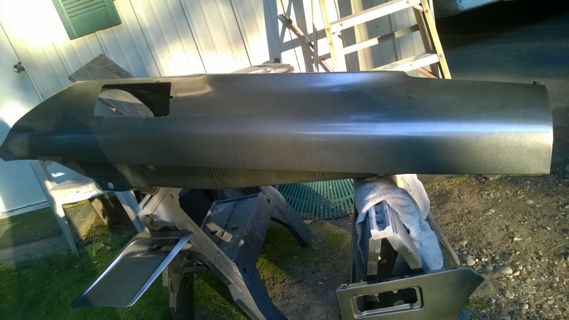

Still working on the front end. Wish I could get myself to stop when I should be stopping when it comes to installing things temporarily. Ended up sanding both fenders entirely and decided to spray them the color I'll be going with instead of white. I'll have to remove the paint anyway so I decided to see them (at least mostly) the way they'll be when it's all painted. Just ended up taking a lot longer than it should have for what I'm doing. Anyway, have one just about ready for install, hope to have it on the car tomorrow. New plug wires will be here tomorrow and hopefully the second set of new fender mounting hardware that I ordered. A lot of money spent on bolts and clips but looking at the rusty bolts up against that fresh paint made me cringe and I didn't want to take MORE time de-rusting fender bolts. I'm probably a couple /3 days out from having the front end installed and I'll take a few pics of that. Once I'm able to drive a bit more and get things all adjusted properly I'll get a few more video clips posted for sure. I know one thing that needs to be a priority is figuring out why the gas gauge is not working! New sending unit installed, tested before install but something's not jivin' for some reason. Really hope I don't need to drop the tank, praying it's the ground but I've messed with that several times already with no luck. First things first though.
