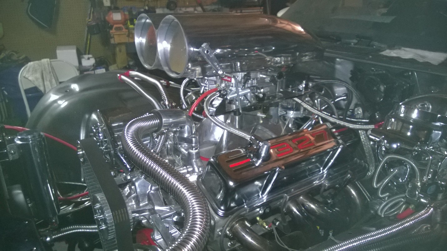

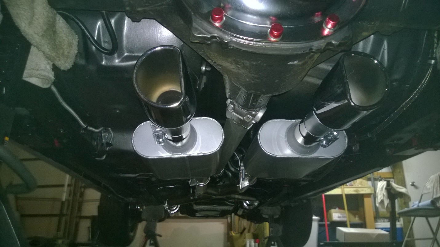

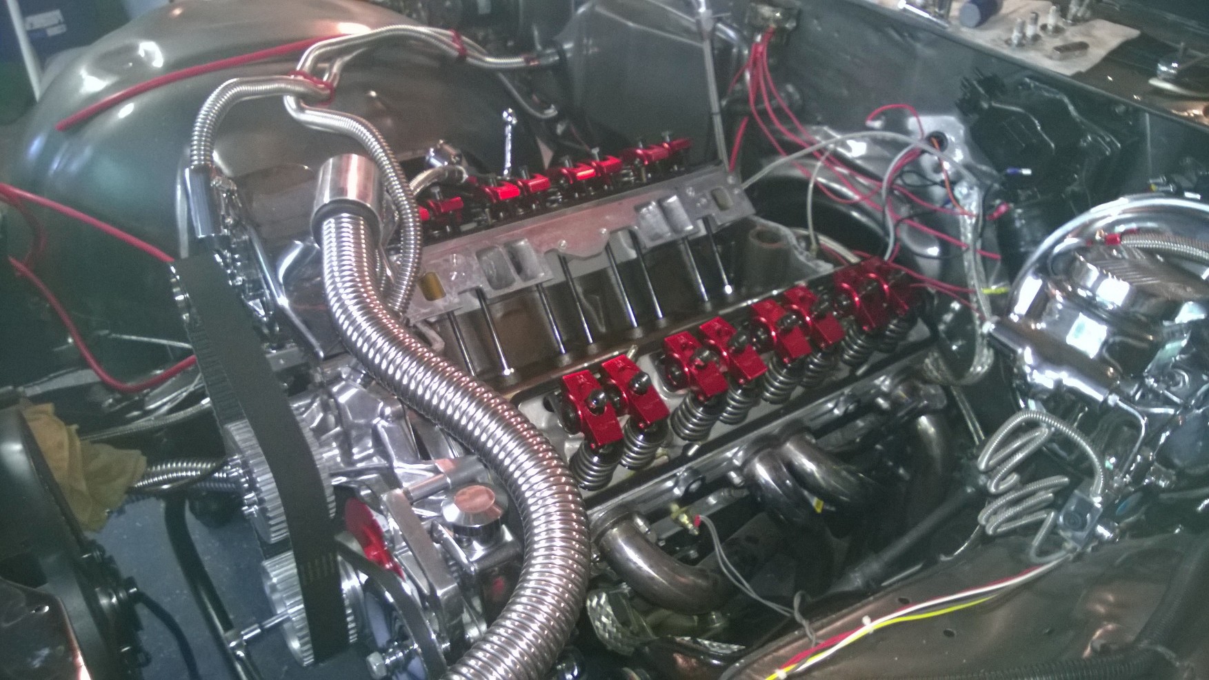

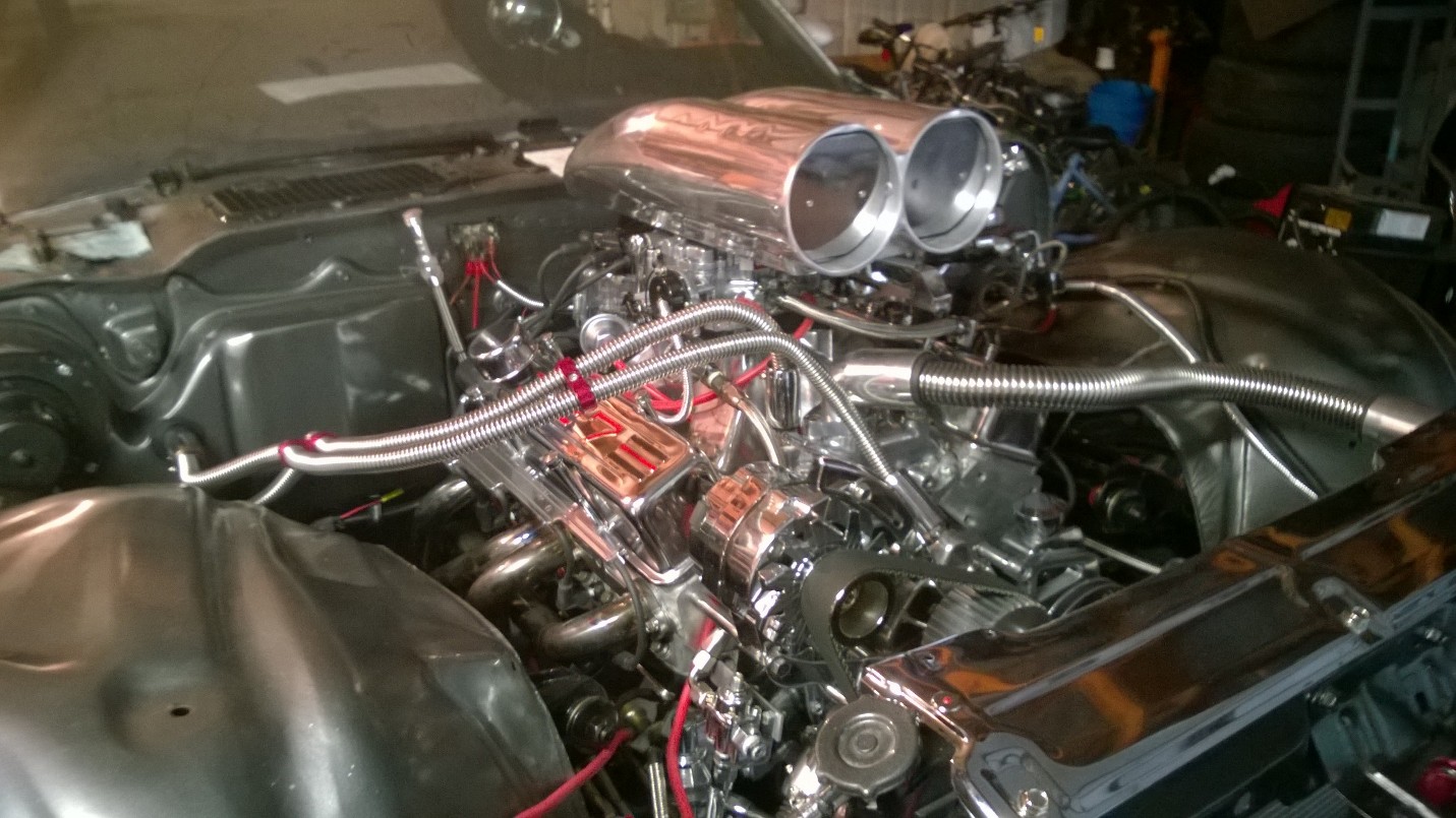

FWIW, I was able to get the engine running properly in my Camaro, finally. Another new distributor, new carb (650 cfm this time) and I pulled the 1206 intake gasket to replace with a 1205. Whatever was causing the problems will forever be a mystery. Rain has kept me from the maiden voyage but I've run through all the gears several times with the car up on stands and the trans (the one I taught myself how to rebuild) is working well. Still have to put the fenders and nose back on but most everything else mechanically is buttoned up.
