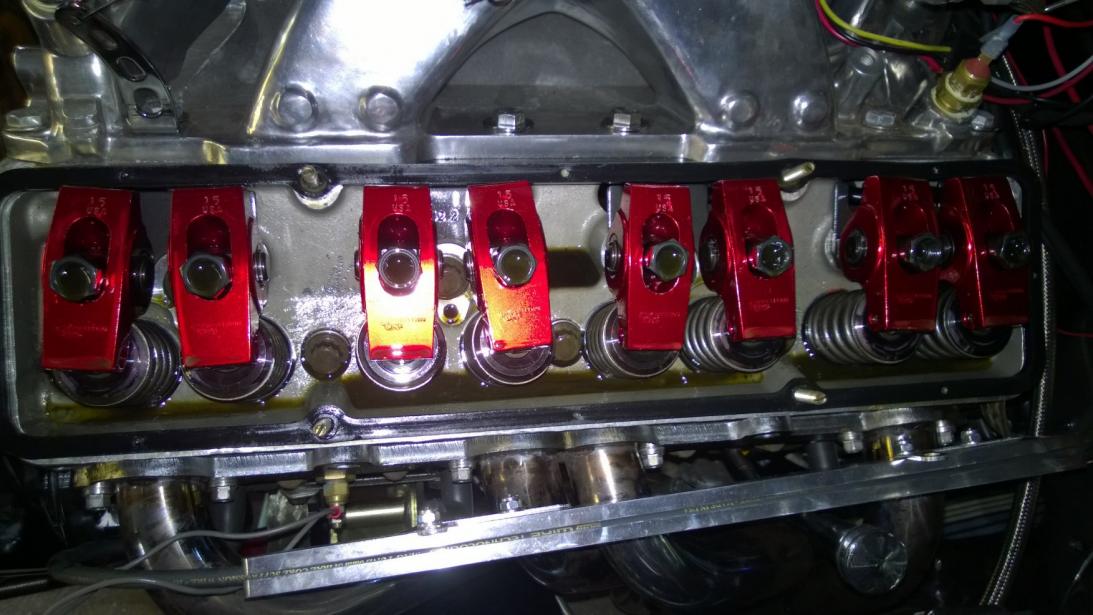

So, rocker arms on the Camaro, I am having a hell of a time trying to hear when the "ticking" starts and stops in the garage! I do believe loosening them up is helping though! I can start the engine and it'll stay running but I keep turning it back off after trying to adjust each cylinder because of all the oil spraying everywhere. It's making a gigantic mess! I have the cut-top valve cover on there, even took a big piece of cardboard to wedge behind the folded up top to stop the oil from going everywhere, but it still is. I'm trying to just suck it up and get 'em done but I literally cannot tell if I got the ticking to stop because it's too loud in the garage with the engine running. I don't want to loosen them too far, just until I hear the ticking right? The rockers are definitely oiling well Vall, it's flipping it over the top of the valve cover (which is folded straight up) plus the cardboard that I wedged in there, which raises the top up another 5-6".

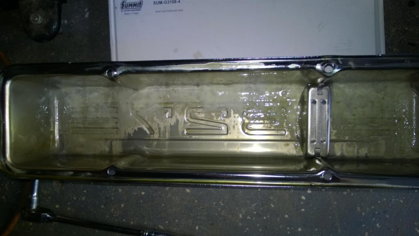

Look what I found on the inside of the valve cover when I removed it. There's no other water in the oil, I believe it's from the grommet where the PCV valve plugs into it. I'm thinking it's from all the mornings where the condensation is so bad everything on the engine has water on it. The grommet is new, but doesn't seal real well, I've already seen oil dripping out of it. There's no white oil anywhere else but on the inside top of the cover. Still thought it was strange though.

The condensation makes sense to me, even if the engine was well sealed. Considering the amount of heating up and cooling down you're doing with all the starts and stops. I wouldn't be concerned about it myself.
I assume your exhaust is pretty loud if you can't hear the clicking. I did mine in my garage, and had no problem hearing that clack when a rocker got loose enough. I'd also guess you've got a high pressure or high volume oil pump if you're getting that much oil going over your barrier. I don't use high volume oil pumps myself, as stock deliver enough pressure, and too much volume or pressure can wash out bearings.
Not sure what to tell you on the rocker adjustment, except to try to keep working on one at a time backing it off until you're sure it's making noise, then turn it down until it goes away.

Good to know about the white sludge in the top of the valve cover, I wasn't really concerned about it since it was only on the inside top of it but thanks for the confirmation.
I don't really think the oil pump is a high volume/pressure one Vall, it looks like a stock one to me. I didn't build the bottom end of this engine however, so I'm not exactly sure either way. It's working good though, guess that's all that really matters. The exhaust is loud, not deafening but it's making it incredibly difficult to hear the noise I'm listening for. I messed up though, I shouldn't have loosened the poly locks on these rockers. I was hoping to make the process quicker by loosening the locks on all 8 so as to streamline the loosening and retightening of the nuts while the engine was running. Thought I had snugged them all just enough to hold but I was wrong. The nuts are extremely easy to loosen/tighten without the poly locks tightened on these and what ended up happening is a couple of the nuts worked themselves loose while I was trying to set #1 and #3. I looked over and saw the rocker for #7 intake laying in front of the valve spring but the engine was still running great. So now I've got a mess of rockers that are too loose, but not necessarily clacking. It just made a job that I was struggling at that much more difficult. I'm thinking that I might as well just start at TDC #1 and go back though the valve lash setting procedure that I did originally. Even though I'll never understand how the lash could've been set too tight on these things, I honestly am beginning to think that loosening them up a bit is going to solve the issues I'm having. After I started loosening the first couple, the engine began to run on it's own without even having to warm it up. It's still running at 1500 rpm and I actually turned the idle screw out A LOT today and it only lowered the idle down to 1300, but it was still running. That's when I noticed #7 intake rocker just laying there though so I shut it off. Not sure why this happened but after I put the rocker back on I tried to restart the engine and the battery was almost dead. It's always something to hinder progress I tell ya! I'm going to reset the lash on all rockers tomorrow and start over. The mess continues to grow with the oil going everywhere and I still can't tell if the 2 cylinders I've tried to adjust are done right. Heading down to Detroit tomorrow afternoon but want to at least have the driver side done and cleaned up before I leave.

Pretty much impossible to look at a oil pump and see if it's a high volume pump. They look identical to a stock pump. The difference is what the pressure gauge reads at idle, or when revving the engine. The stock pump is pretty consistent in pressure, so the high and low readings aren't much different between idle and cruise speed.
I don't think you originally did anything wrong when setting the valves. I just think the lifters may be the issue, and only way to fix them is setting them while running. The poly locks and nuts are really going to be a PITA while adjusting. It's always tough to try and set them, and keep it set while trying to tighten the setscrew, and not lose the setting. It might take a bunch of time starting and stopping to get it done, but it will idle better once you've got them all set.
