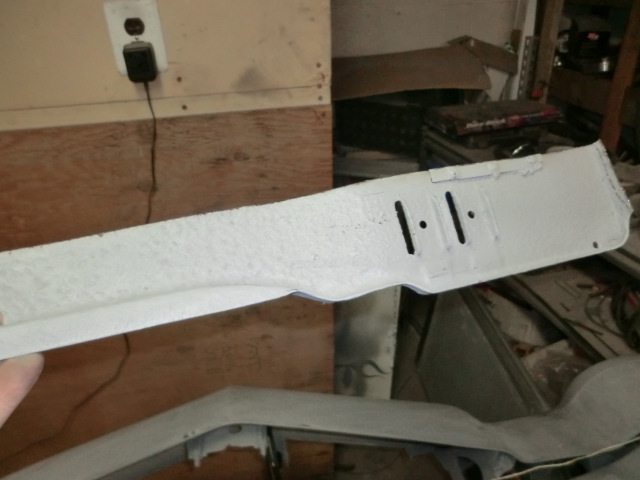

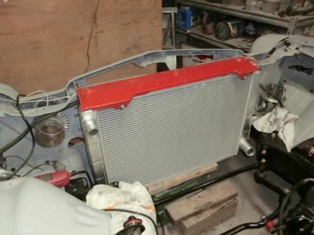

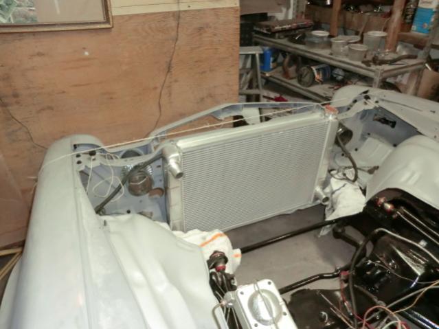

The rad support is working out pretty good. It is tacked together, I'll finish it next time I have the front end apart.

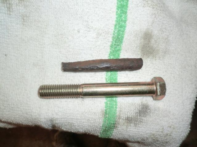

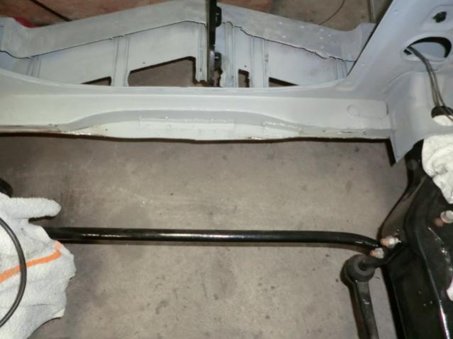

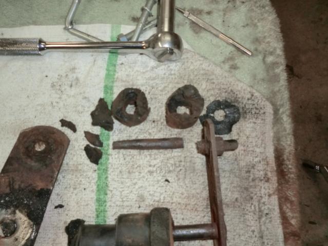

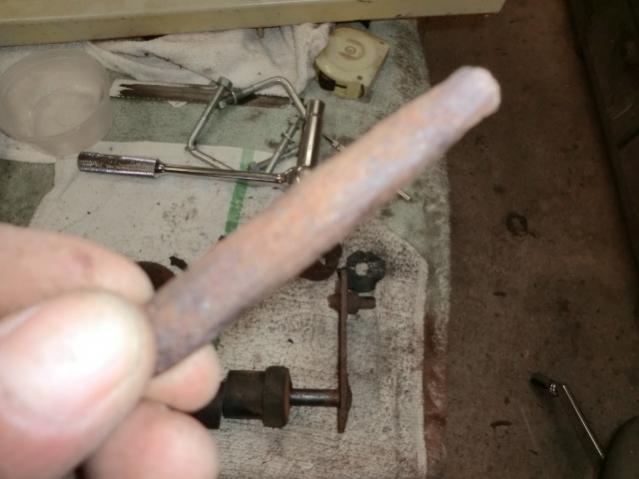

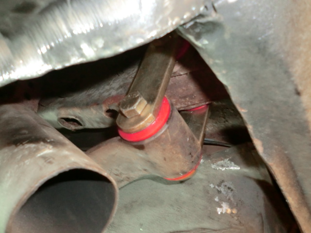

Redid the rear shackles and bushings. That kicked my A$$! Too many times up and down on concrete. I used to do this stuff in gravel 30 years ago. Used three of these torch blades. They are tough! Maybe I didn't really need to repair this! LOL

  #376
Wow. I like the torch blades myself. I bet that was good on the back.

but atleast now it will be good for another 30 years without worry of should i have replaced them,mine need done too when i get that far seems i cant get past the front clip,just finding a decent radiator support seems never ending.

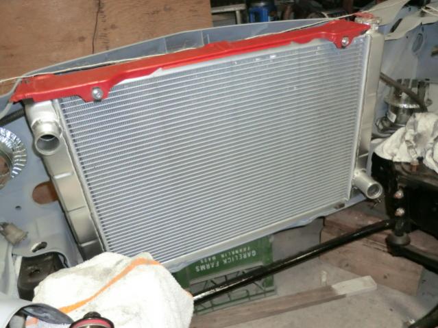

Remember I had to repair and upgrade this. I'm putting 300hp to the wheels.
I had already repaired my rad support, and then I cut the bottom off to fit the new radiator.

yeah u did a really good job of repairing ur radiator support wish mine wasnt so rusted maybe i can try to weld new metal in it,probably better than buyinbg a junk used one anyway i mean there 30+ years old there gonna have some rust,how much did u have too drop the bottom to make it fit.by the way rydeer them new rear shackle really look good on there i like the red bushings and ur frame rails look in very good condition.

I cut out the bottom and dropped it approx 1 inch. It isn't finished. I'll wait until I remove it and finish weld it on the bench.
