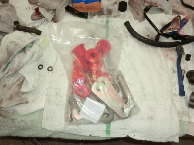

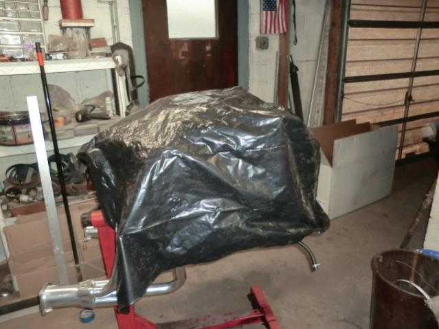

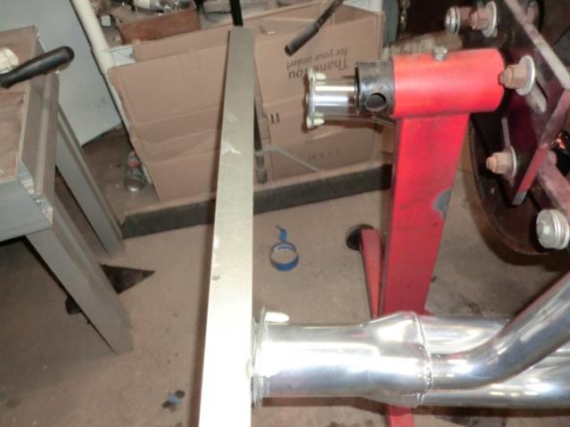

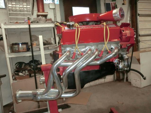

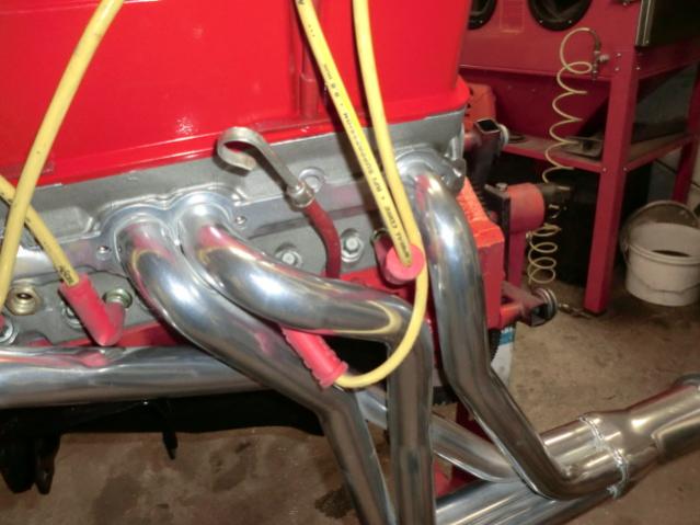

I put the motor together and it will go away for storage. The rear shackle kit arrived. The headers fit the motor good.They are dimpled for the angle plug heads correctly. I noticed that one is longer than the other.The collector adapters are the same.I'll have to get some new wires,I don't know why two wires have the straight bendable end. and the lengths are all over the place.

it probably was one of them universal wire sets,and they didnt cut them to the right length and installed diffrent boots for some reason.
