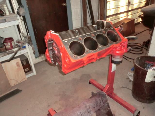

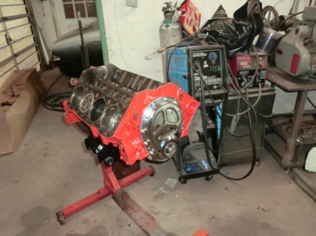

The new parts arrived Thurs PM. Everything is ready to go. I painted the block and started gapping rings. Think I got high from environmental brake ckeaner. Leaning over the bores gapping rings and I start to fly...reminds me of the 70's. I'll let the air clear awhile and go back!

It's sure going to look nice when all that extra bling is on and sitting in the car!

yeah it will be all blinged up and sitting in a bag,while I finish sanding the car!

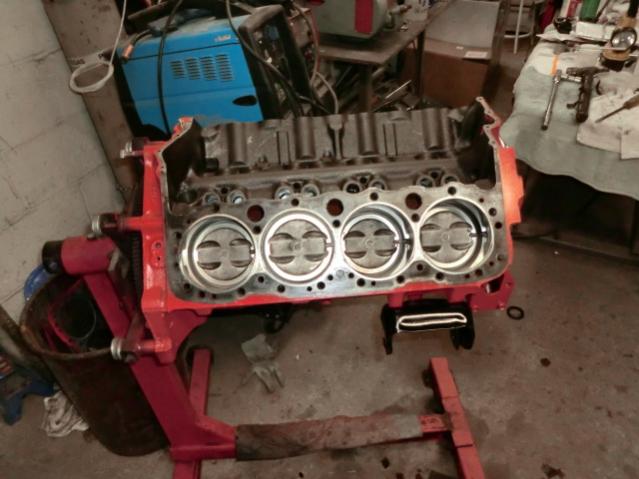

I have all the rings gapped and installed on the pistons. I'll start assy tomorrow.

I hate gapping rings. I pull a chair up the the motor and have a seat. Then there is the constant worry you'll remove too much.

Rings went well. Didn't touch an oil scraper, Filed every 2nd and only 2 tops.

Pretty lucky! I've rarely put a set in that didn't need over half of the top two rings touched up.

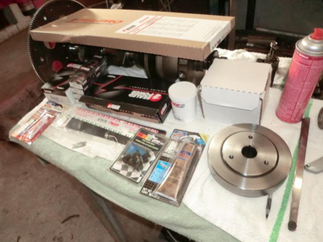

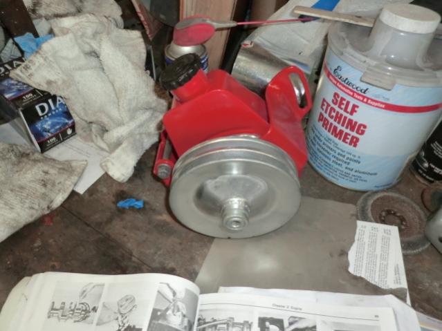

Well I have a long block. All clearances checked and spot on. The oil pump arrived with a direction sheet stating I must use a steel adapter. Why didn't they tell me up front or include the darn thing. Now I have to research the right part and order.
