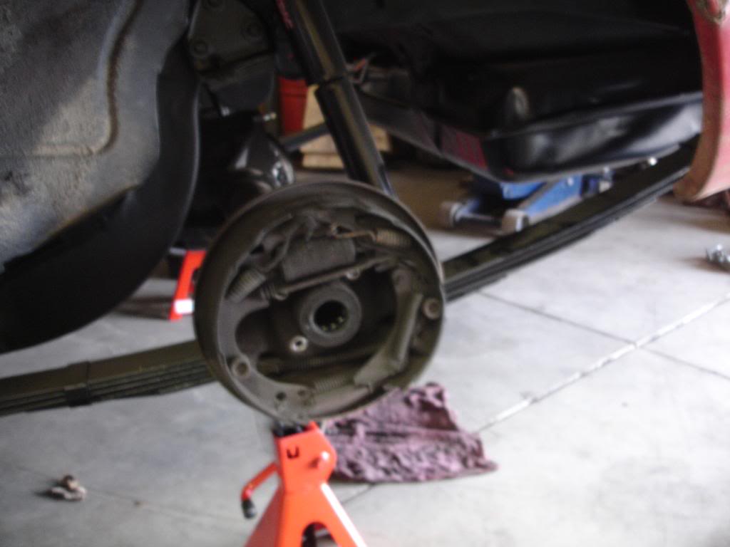

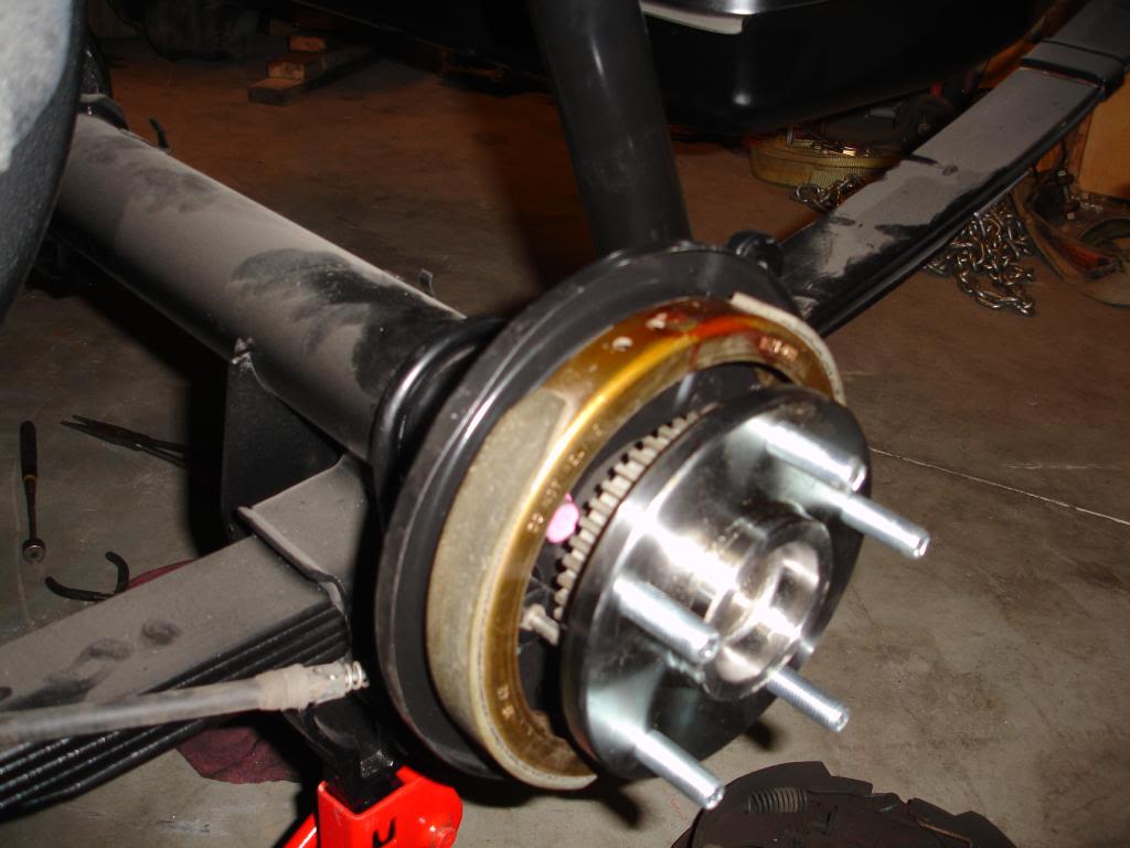

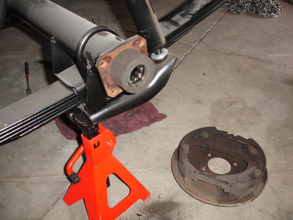

Started in pretty standard fashion. Removed the nasty old drums and axles followed by the backing plates. I put new axle seals in as well while I was there.

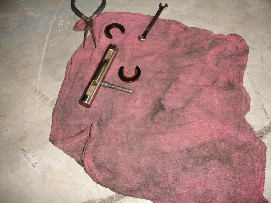

The bits and pieces

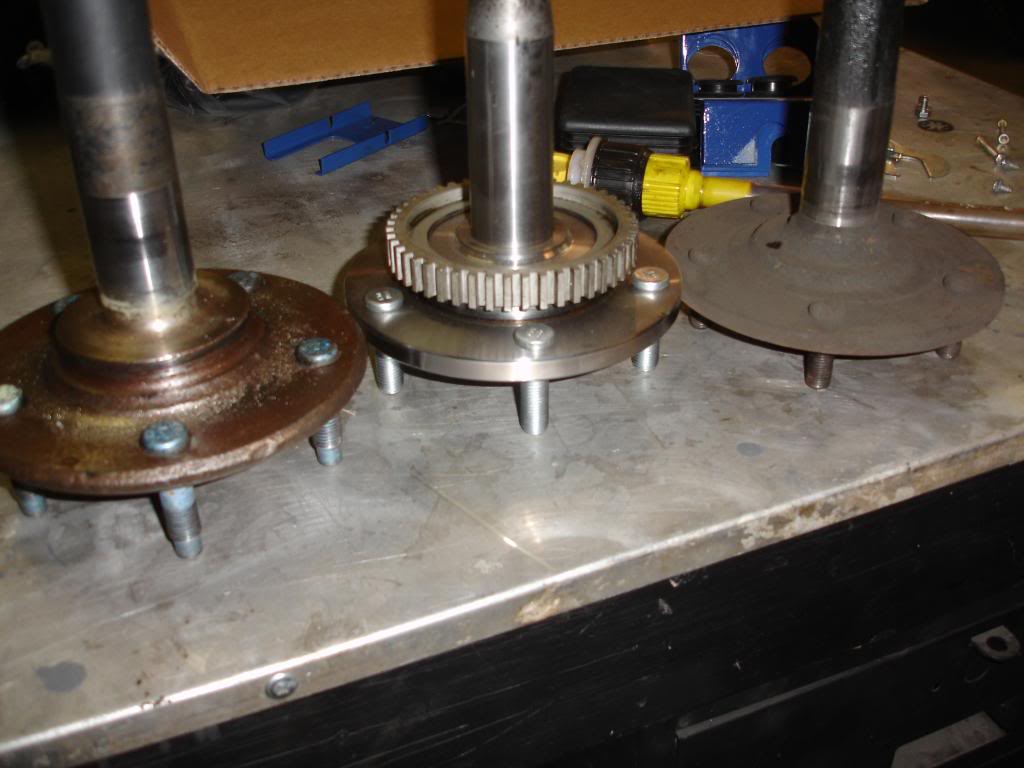

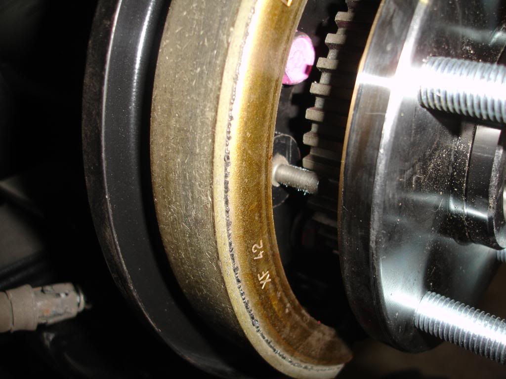

After I transferred the sensor rings off the Trans Am axles.
Here is all three for comparison

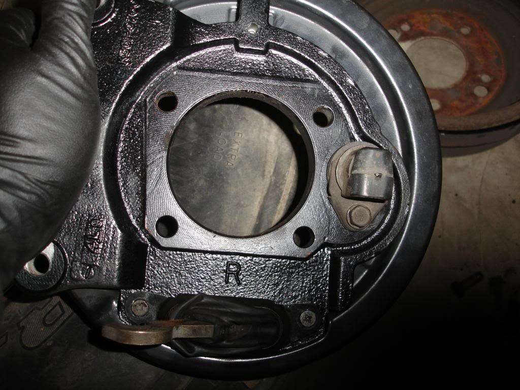

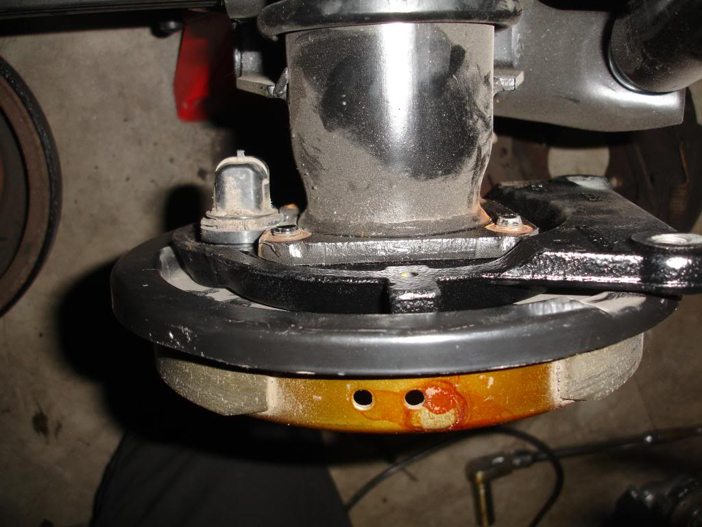

Here is the backing plate/caliper mount with the ABS sensor installed. there is a clearance issue with the sensor. (thanks Damon for that info) a simple grind is a quick fix. For my install I chose to have the calipers behind the axle so I used the Right backing plate on the left side of the car.

The sensor and ring

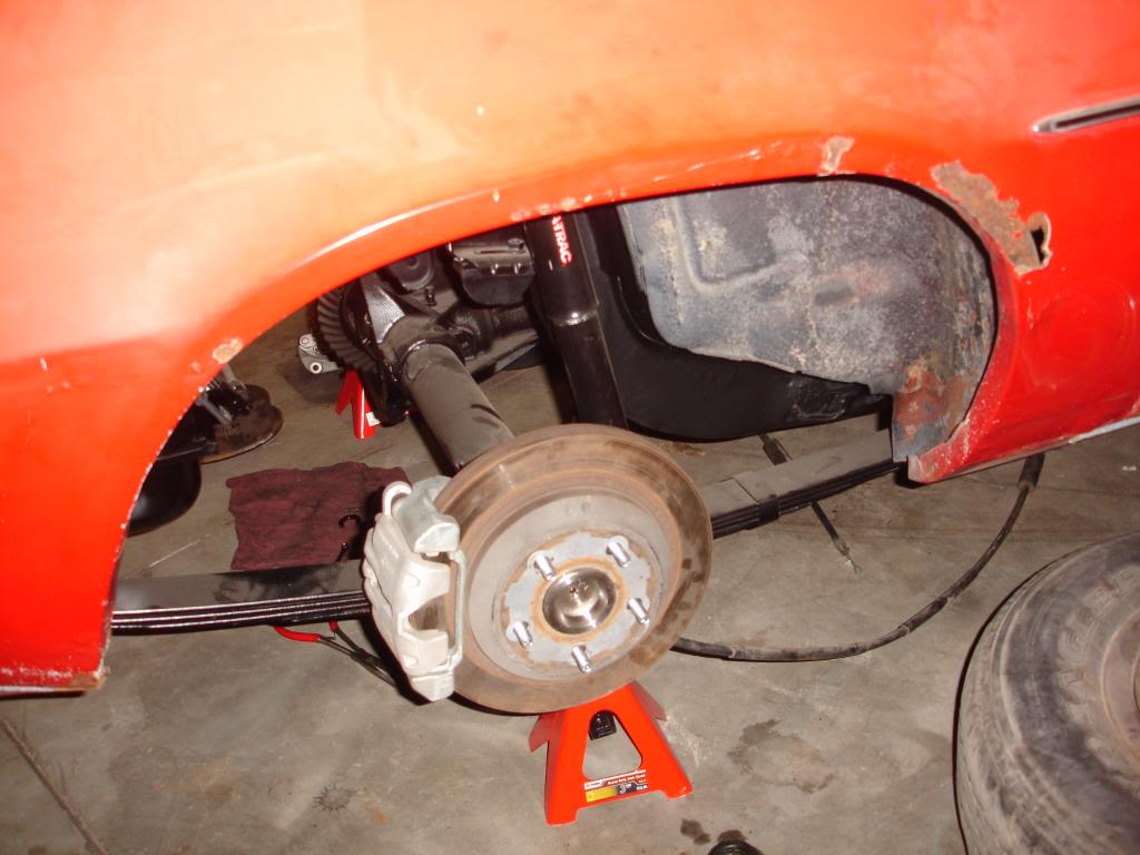

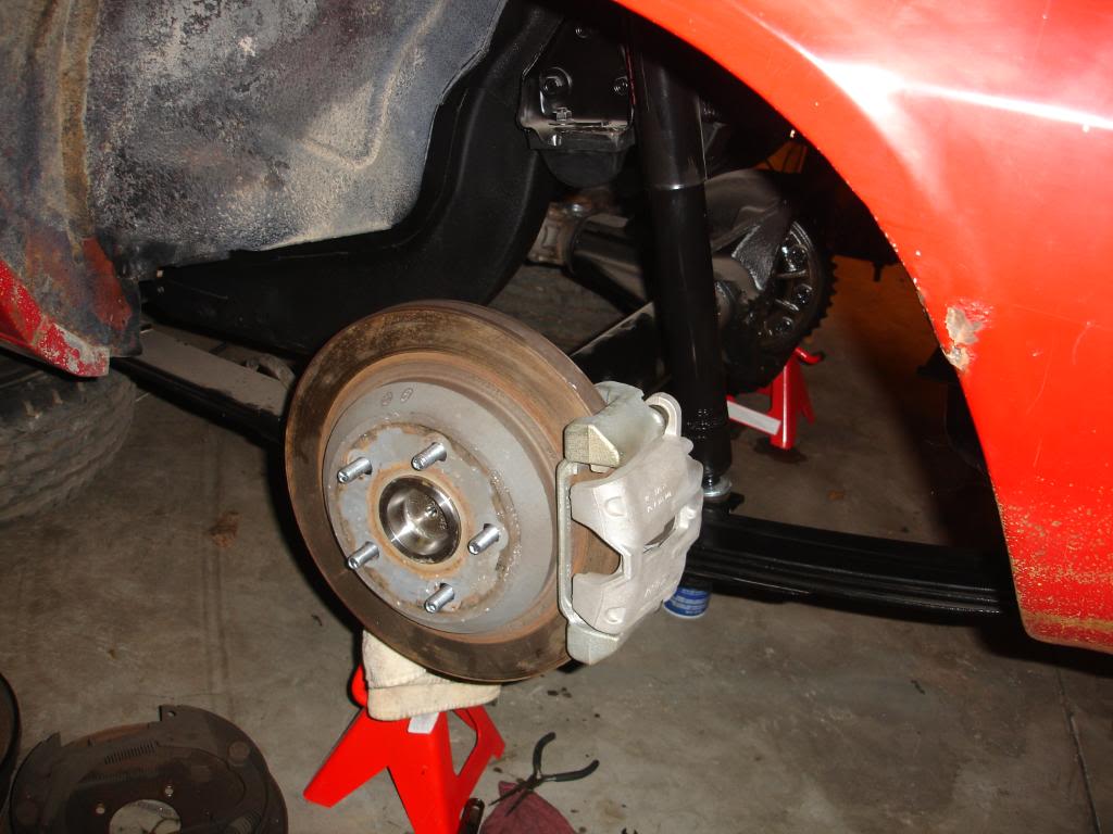

After it's all put together

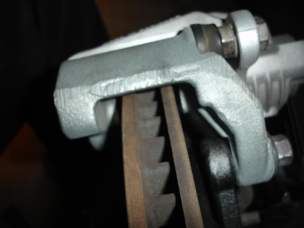

I've read that some people used spacers to center the caliper to the rotor. but when I installed them there is only 1 millimeter from being perfectly center. I'm not going to even worry about it.

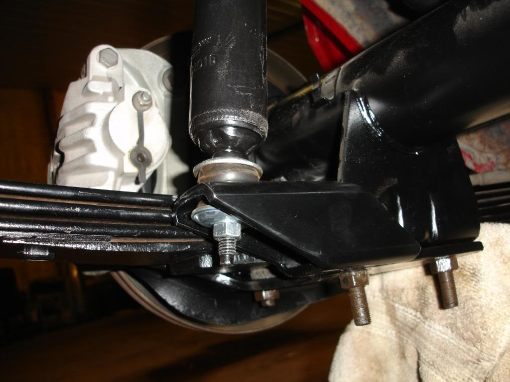

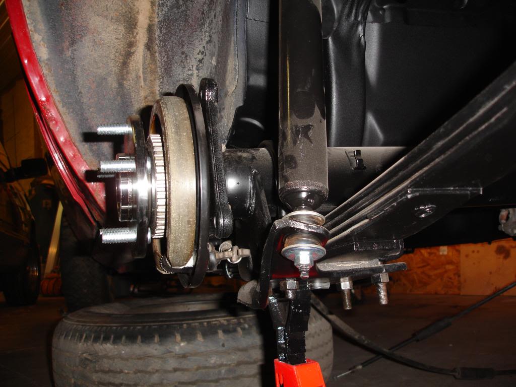

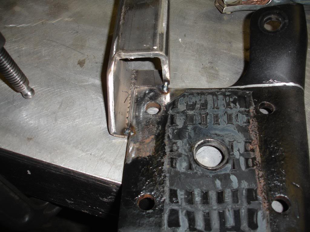

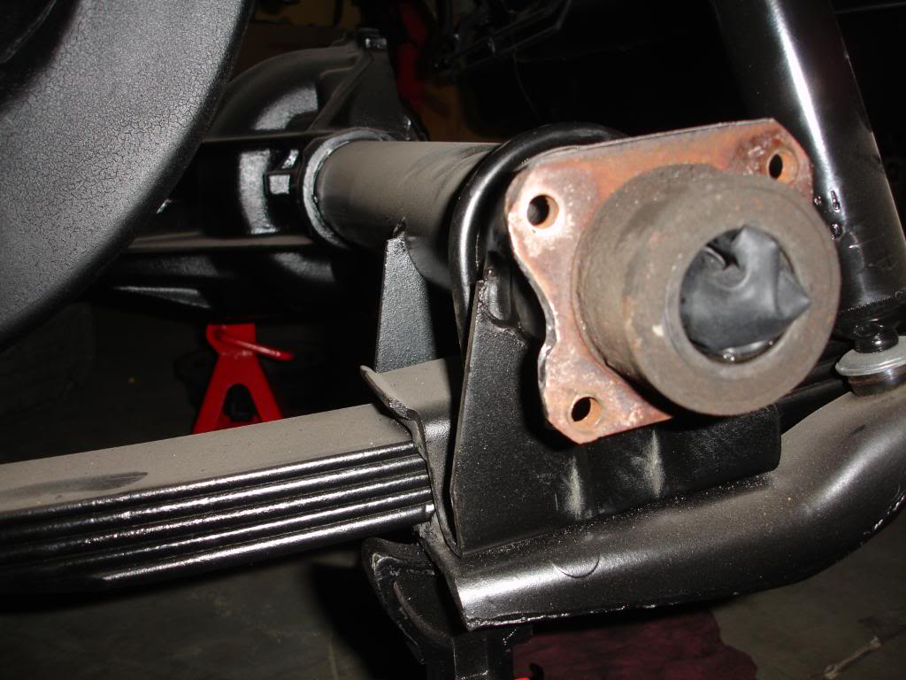

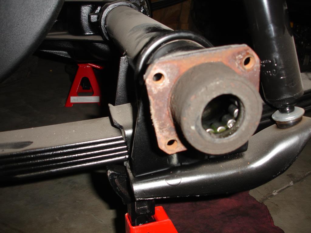

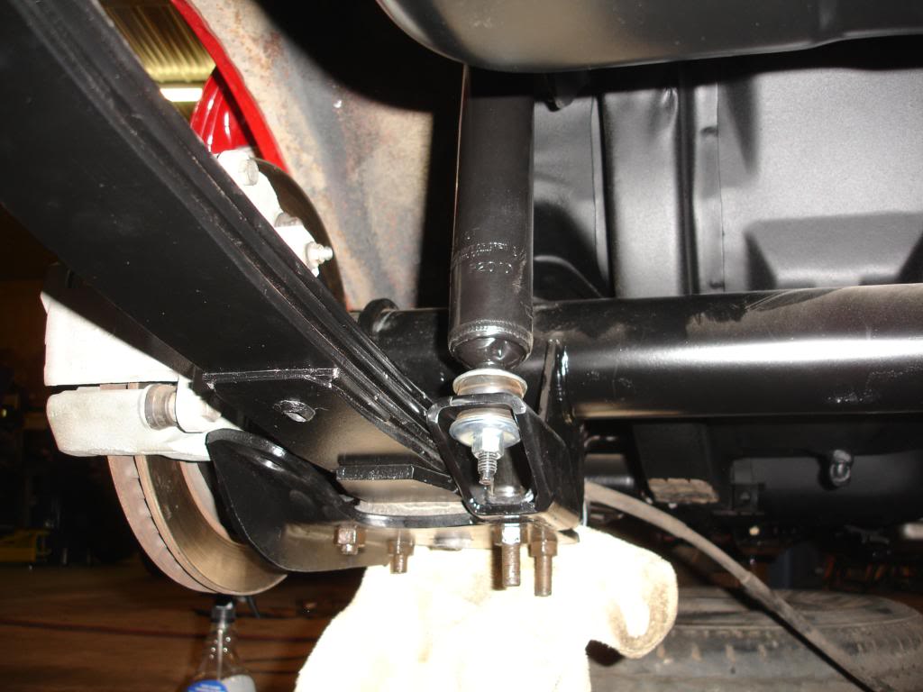

Of course there is an issue with the driver side shock in the same space as the caliper wants to be. I'm going to move the shock mount to the inside of the leaf spring.
Kind of like so

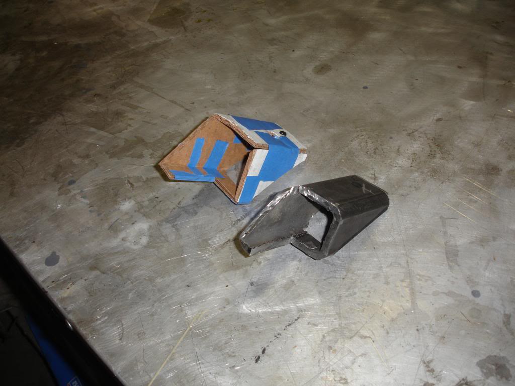

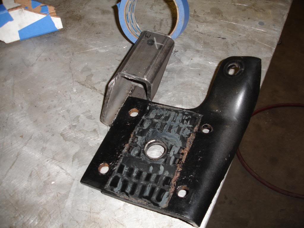

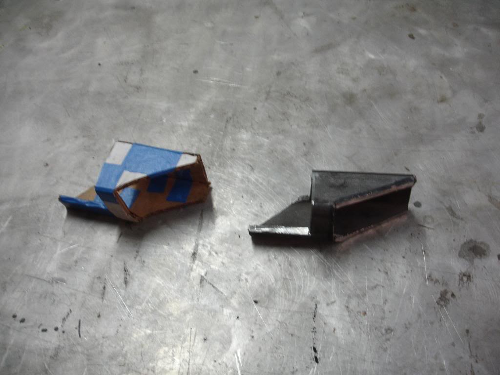

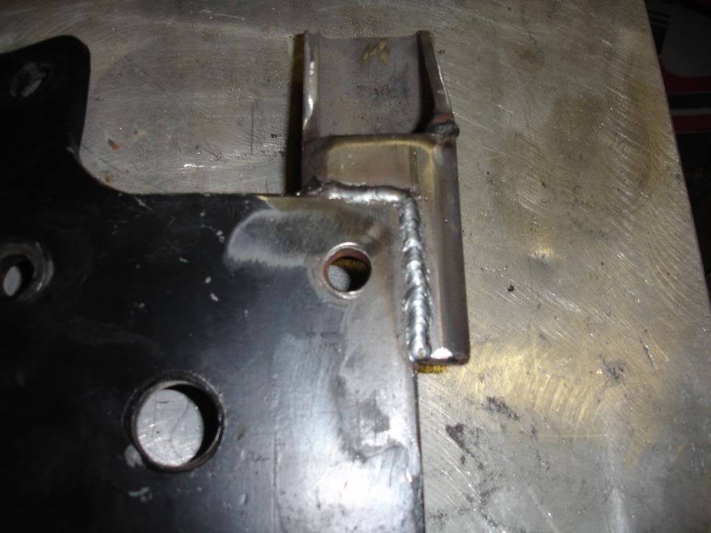

I was going to flip the original bracket upside and modify it to make it work. but I figured it would be cooler to make a new bracket and weld it on.
I made one out of cardboard to see how it would work.
Here is how it's going to fit together

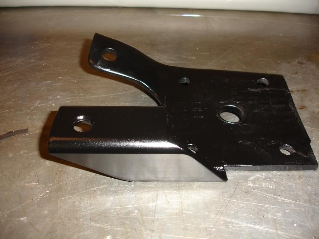

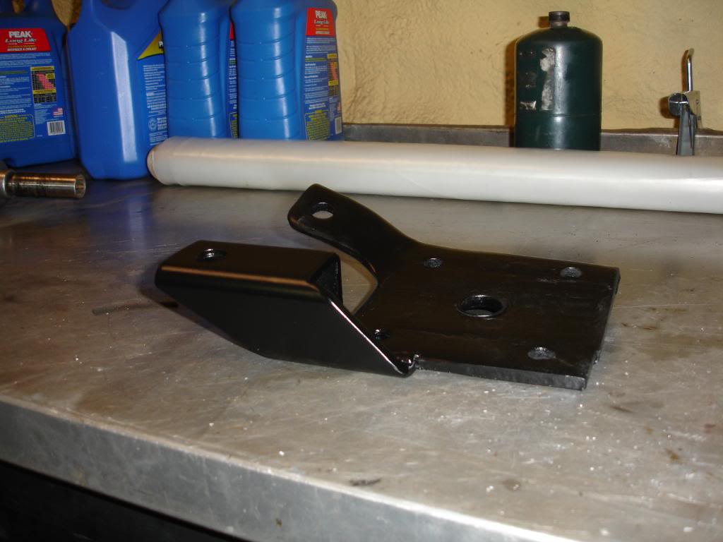

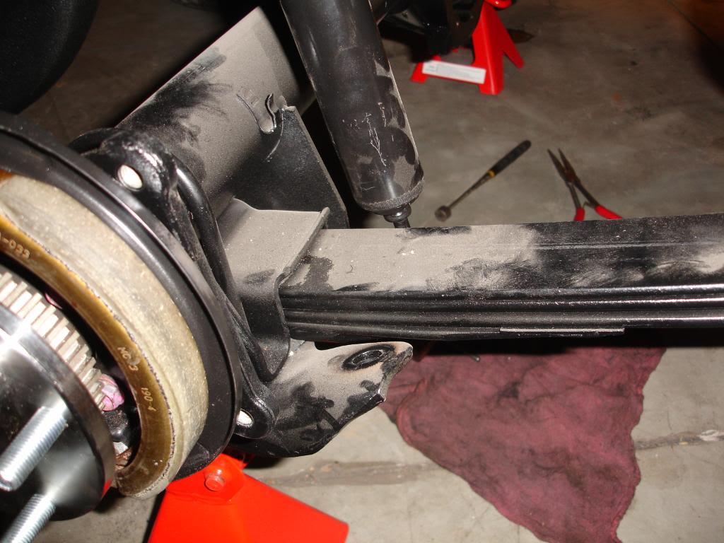

I think in the snow stopping with or without abs is a B#### lol. but anyways here is are some pic of the shock bracket done.
Just tacked on
Tested fitted and then burned in it.
Painted
finished. I was going to cut the original shock bracket off but I decide to keep it around unless it gets in the way.
And thats all of now folks.

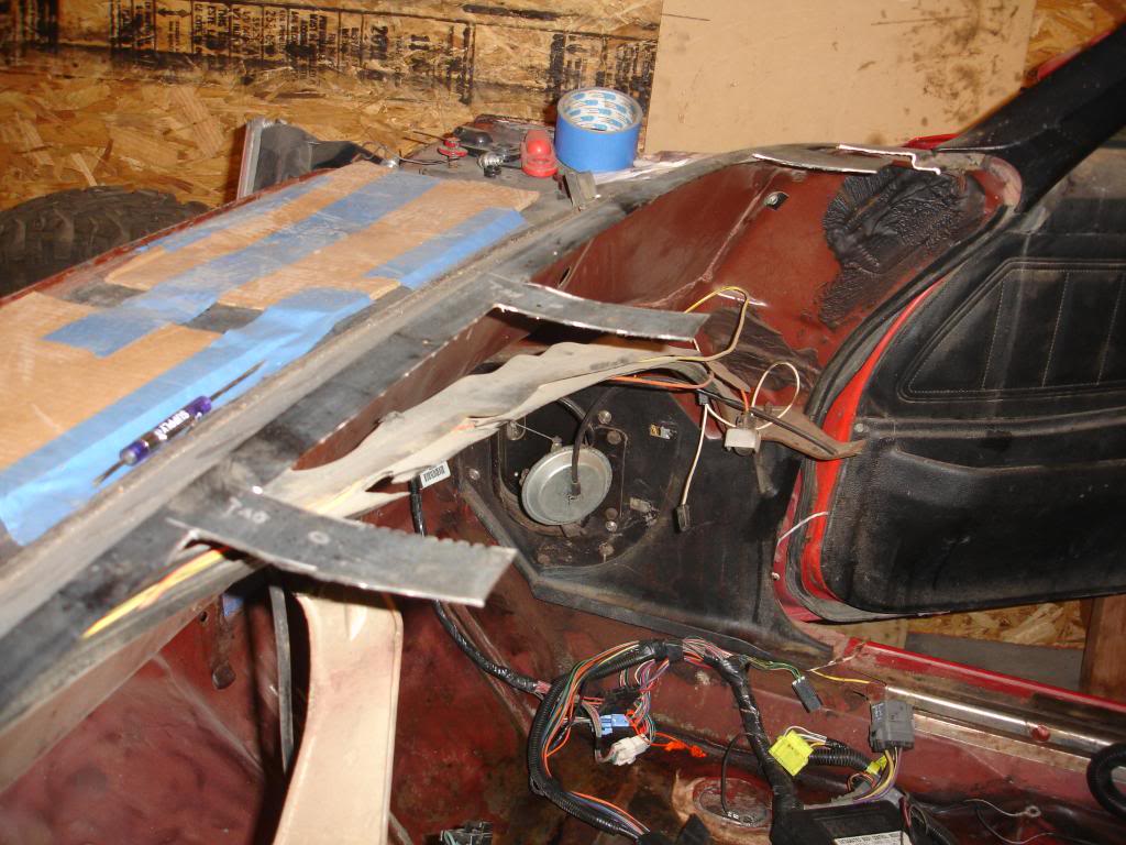

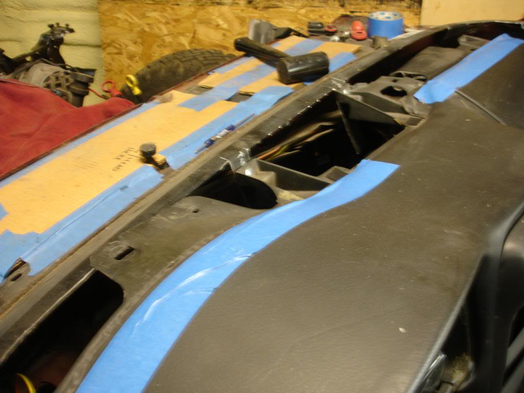

I started on installing the Dash.
Had to chop some of the dash
I'll post more later
